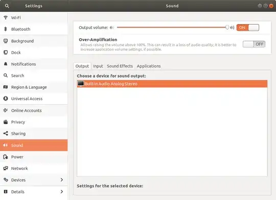

I have a Dell xps13 that previously had 14.04 and the sound worked fine. I recently installed 18.04 and now I have no sound through either my speakers or headphones. The sound settings look like this: enter image description here (Note that there is no 'Test Sound' button. )

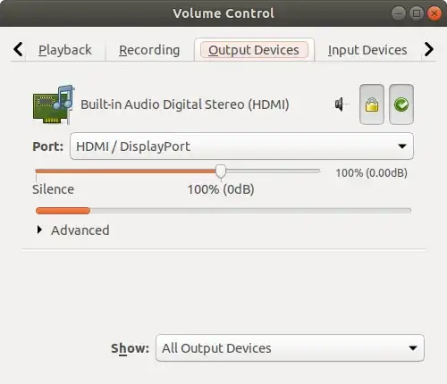

I've checked with pavucontrol to make sure that nothing is muted. This is what the panel looks like:
(The lower bar indicates that sound is playing, but I don't hear anything out of the speakers/headphones.)

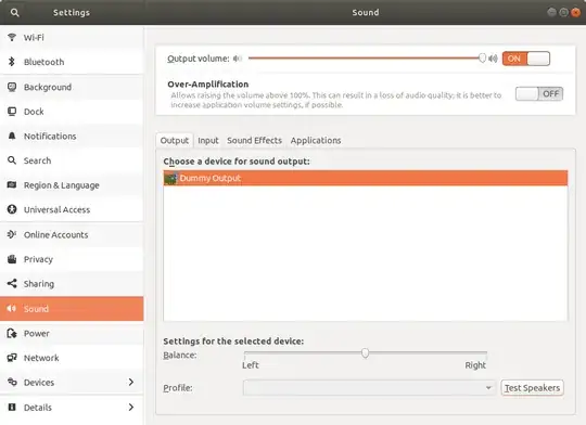

and restarted. Now I have only dummy output listed:
The standard answer online to fix the 'dummy output' problem is to run pulseaudio -k && sudo alsa force-reload but this does nothing. Trying to figure out what to do now...
