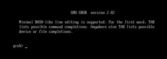

After I ran into systemd-boot as boot-loader I've never looked back at GRUB.
systemd-boot, is in my view, way more stable and has a much better way of configuration.
And by "stable" I mean it's not as vulnerable as GRUB. GRUB is so easy to break.
Just adding a new disk to your box can give you big trouble (because of maybe identical boot-loader ID's that you cannot change etc.)
