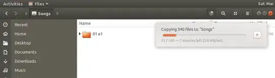

There is a change on Ubuntu 18, it shows a small icon on top bar, click that to show progress.
