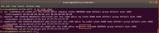

To display what network interfaces are available in the system, issue the following command:
$ ip link show
enter image description here Figure-39: The WiFi network adapter wlp5s0 is active, up and running.

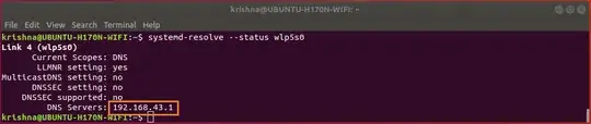

$ systemd-resolve --status wlp5s0
enter image description here Figure-43: The default DNS server for WiFi network adapter is 192.168.43.1.

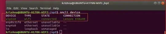

After setting up sysmlink as shown in figure-45, you must make sure that your Wi-Fi is connected, up and running, by issuing the following command:
$ nmcli device
enter image description here Figure-45-a: Wi-Fi network interface adapter 'wlp5s0' is connected, up and running.

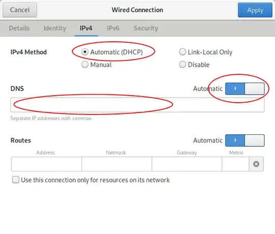

  3. Finally, set your DNS servers here.
    Set DNS Automatic to OFF. Enter comma-separated DNS IP addresses.
    screenshot
