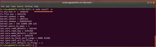

Run the following command to display the current kernel parameters.
$ sudo sysctl -p enter image description here Figure-7: The list of Kernel Parameters configured in "/etc/sysctl.conf" file.

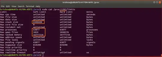

$ ps -a | grep -v tty2 | grep gnome-shell enter image description here Figure-14: PID for gnome-shell.
$ sudo cat /proc/1202/limits enter image description here Figure-15: Soft limits for gnome-shell (marked in red).
MaxStackSize is 8,192 KB (8388608 % 1024), MaxProcess is 63,077, MaxOpenFile is 1,024 and MaxLockedMemory is 16,384 KB (16777216 % 1024). Compare these values with figure-11.

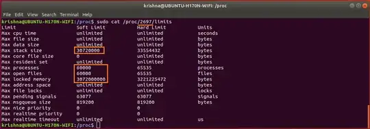

$ sudo cat /proc/2697/limits enter image description here Figure-17: Soft limits for 'bash' (marked in red).
MaxStackSize is 30,000 KB (30720000 % 1024), MaxProcess is 60,000, MaxOpenFile is 60,000 and MaxLockedMemory is 3,000,000 KB (3072000000 % 1024). Compare these values with figure-13.

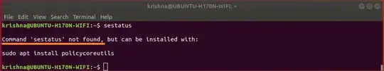

1.8. Configure secure Linux. To ascertain that the computer has configured for secured linux, type the command:
$ sestatus enter image description here Figure-18: Output confirms that secured linux is not installed which is good.
If you get an output like above Figure-18, then you are good! Now, you break this step and move ahead to next step-1.9.

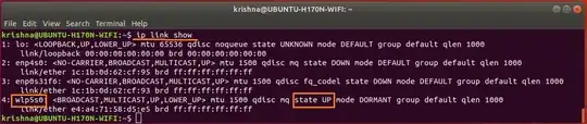

To display what network interfaces are available in the system, issue the following command:
$ ip link show enter image description here Figure-39: The WiFi network adapter wlp5s0 is active, up and running.

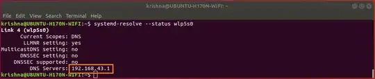

$ systemd-resolve --status wlp5s0 enter image description here Figure-43: The default DNS server for WiFi network adapter is 192.168.43.1.
Display contents of /run/systemd/resolve/resolv.conf, by the command:
$ cat /run/systemd/resolve/resolv.conf enter image description here Figure-44: The contents of '/run/systemd/resolve/resolv.conf' indicating default nameserver. Compare with figure-43
From figure-44, you can observe that /run/systemd/resolve/resolv.conf is the one which really is carrying the default name server 192.168.43.1.

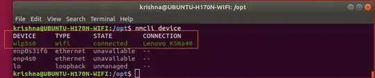

After setting up sysmlink as shown in figure-45, you must make sure that your Wi-Fi is connected, up and running, by issuing the following command:
$ nmcli device
enter image description here Figure-45-a: Wi-Fi network interface adapter 'wlp5s0' is connected, up and running.

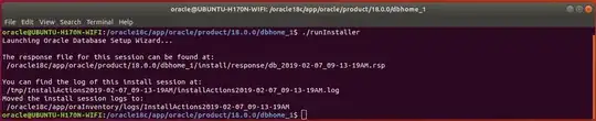

Run runInstaller command from the Oracle home directory only. Do not use the runInstaller command that resides at $ORACLE_HOME/oui/bin/, or any other location, to install Oracle Database, Oracle Database Client, or Oracle Grid Infrastructure.
From the Oracle home directory, run the runInstaller command to start the Oracle Database Setup Wizard.
$ cd /oracle18c/app/oracle/product/18.0.0/dbhome_1
$ ./runInstaller
enter image description here Figure-64: Execute 'runInstaller' from '/oracle18c/app/oracle/product/18.0.0/dbhome_1/' directory.

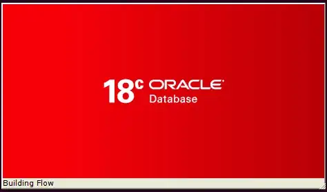

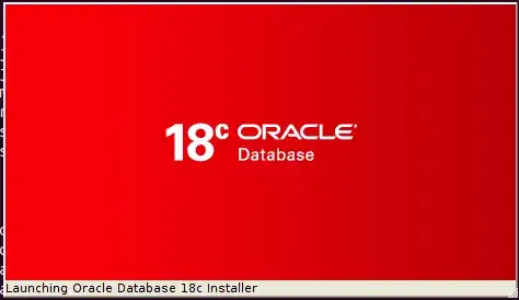

enter image description here Figure-65: Launching Oracle Database 18c Installer.

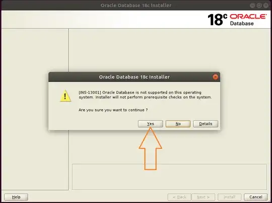

enter image description here Figure-66: Hit button Yes and go ahead with installation.

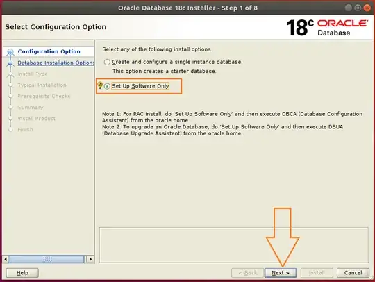

enter image description here Figure-67: Select 'Set up Software Only' option and press Next.

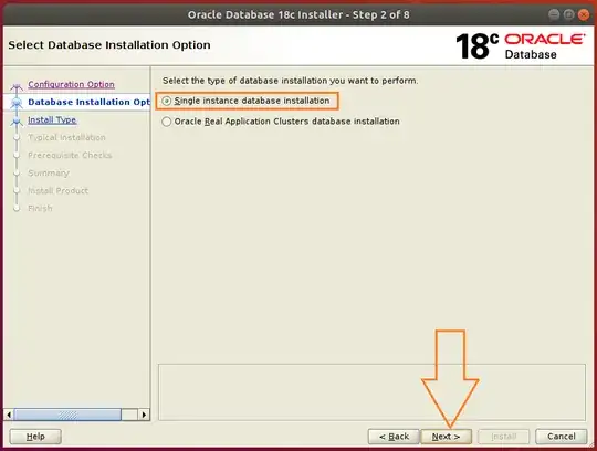

enter image description here Figure-68: Select 'Single instance database installation' option and press Next.

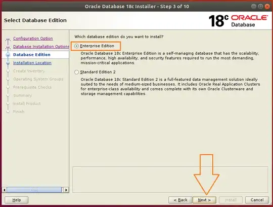

enter image description here Figure-69: Select 'Enterprise edition' option and press Next.

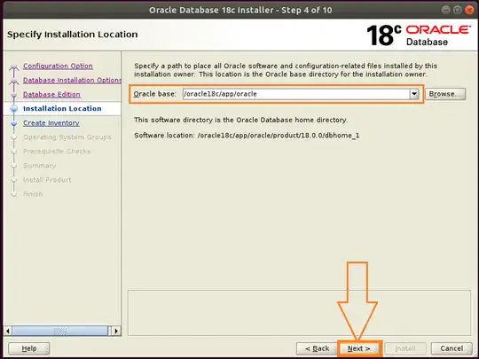

enter image description here Figure-70: Accept the default 'Intallation Location' and press Next.

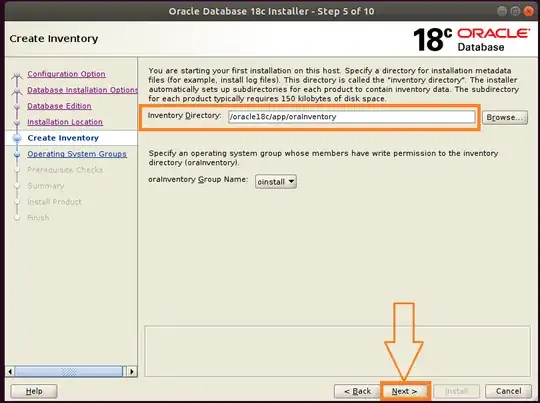

enter image description here Figure-71: Accept the default Oracle Inventor directory/oracle18c/app/oralInventory and hit Next.

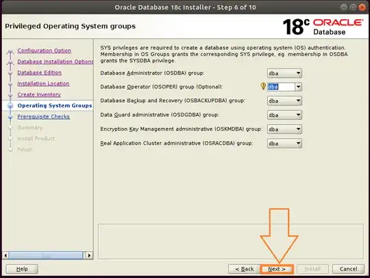

enter image description here Figure-72: Select Operating System Groups and press Next.

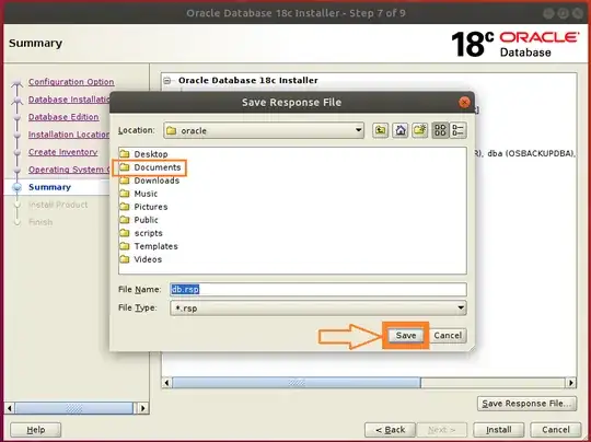

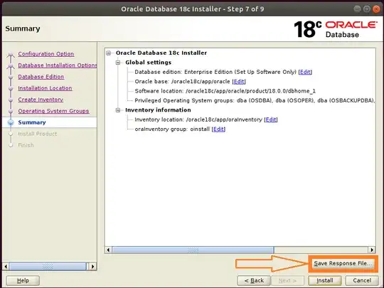

enter image description here Figure-73: This is Summary screen and Click button 'Save Response File' to take a copy of 'db.rsp' file.
enter image description here Figure-74: Double-click "Documents" folder and then save a copy of 'db.rsp' file by clicking "Save" button.
Please save the response file db.rsp in ~/Documents directory. This is for your reference.

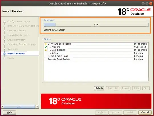

enter image description here Figure-75: Now click Install button on the Summary Screen to proceed further.

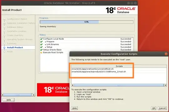

enter image description here Figure-76: Now Install Product is under progress…...

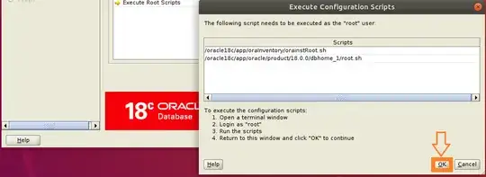

enter image description here Figure-77: Execute both the scripts one after another with "root" login.
Open up a 2nd Terminal by typing Ctrl+AlT+T. Login into command line as root user by typing su –:
$ su -
Copy the entire path of first script orainstRoot.sh and paste it on the terminal (prefix command with ". ")
# . /oracle18c/app/oraInventory/orainstRoot.sh
enter image description here Figure-78: Execution of first script orainstRoot.sh with "root" login.

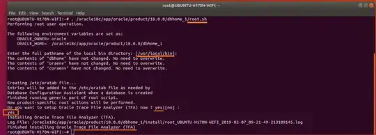

Now, copy the entire path of the second script root.sh and paste it on the terminal (prefix command with ". ") and hit <CR>.
# . /oracle18c/app/oracle/product/18.0.0/dbhome_1/root.sh
During execution of this script, you will be asked "Enter the full pathname of the local bin directory: /usr/local/bin:". You simply accept this "default bin directory" path by pressing the <return> key.
There will be another question subsequently asked, "Do you want to setup Oracle Trace File Analyzer (TFA) now ? yes [no] : " for which you type "y" and get it installed.
enter image description here Figure-79: Execution of second script root.sh with "root" login.
After completion of the execution of both scripts with "root" login, you should go back to installer and hit OK button in order to go ahead with the installation (refer screenshot below figure-80).
enter image description here Figure-80: After the execution of scripts hit OK button and proceed further.
enter image description here Figure-81: Click Close button to finish Database software Installation.
enter image description here Figure-82: Congratulations! You have successfully installed database software using runInstaller interactively!!

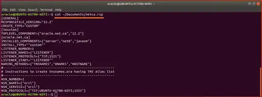

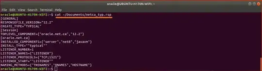

$ cp /oracle18c/app/oracle/product/18.0.0/dbhome_1/network/install/netca_typ.rsp ~/Documents/.
Type cat netca_typ.rsp command to list contents of netca_typ.rsp file:
$ cat ~/Documents/netca_typ.rsp enter image description here Figure-83: The contents of typical 'netca_typ.rsp' capable of generating 'listener.ora' and 'sqlnet.ora'
The response file is although capable of creating listener.ora and sqlnet.ora but not tnsnames.ora. So, let us wise up netca_typ.rsp to turn into"custom" type in order to generate TNS alias!
First take a copy from netca_typ.rsp to netca.rsp and then issue commands subsequently:
$ cp ~/Documents/netca_typ.rsp ~/Documents/netca.rsp
$ sed -i 's/TYPICAL/CUSTOM/' ~/Documents/netca.rsp
$ sed -i 's/typical/custom/' ~/Documents/netca.rsp
Using vi editor, copy & append the following contents to netca.rsp:
# Instructions to create tnsnames.ora having TNS alias list
NSN_NUMBER=1
NSN_NAMES={"orcl"}
NSN_SERVICE={"orcl"}
NSN_PROTOCOLS={"TCP;UBUNTU-H170N-WIFI;1521"}
Warning: Please don't forget to replace UBUNTU-H170N-WIFI with your Computer Hostname.
Note-1: To print your computer hostname, issue this command: $ hostname
Note-2: To print your computer FQDN, issue this command: $ hostname -f or $ hostname -A
Save and exit from vi editor.
The contents of wised up netca.rsp who is now capable of generating tnsnames.ora is shown below:
$ cat ~/Documents/netca.rsp enter image description here Figure-84: The wised up 'netca.rsp' now generates not only 'listener.ora' and 'sqlnet.ora' but also 'tnsnames.ora'.

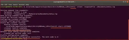

Run network configuration assistance tool netca:
$ /oracle18c/app/oracle/product/18.0.0/dbhome_1/bin/netca -silent -responseFile ~/Documents/netca.rsp
enter image description here Figure-85: NETCA has configured Listener as well as Net Services successfully executed in silent mode.

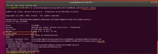

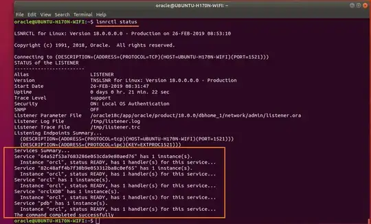

Check Listener status by typing these commands:
$ export ORACLE_HOME=/oracle18c/app/oracle/product/18.0.0/dbhome_1
$ /oracle18c/app/oracle/product/18.0.0/dbhome_1/bin/lsnrctl status
enter image description here Figure-86: Output of 'lsnrctl status' command.
The Trace Level is set off as seen in the above figure-86. The permitted values for trace level are off, user, admin and support. Use vi editor and copy & paste the below contents into listener.ora.

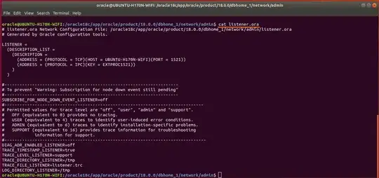

$ cd /oracle18c/app/oracle/product/18.0.0/dbhome_1/network/admin
$ vi listener.ora
# To prevent "Warning: Subscription for node down event still pending"
SUBSCRIBE_FOR_NODE_DOWN_EVENT_LISTENER=off
# Permitted values for trace level are "off", "user", "admin" and "support".
#   OFF (equivalent to 0) provides no tracing.
#   USER (equivalent to 4) traces to identify user-induced error conditions.
#   ADMIN (equivalent to 6) traces to identify installation-specific problems.
#   SUPPORT (equivalent to 16) provides trace information for troubleshooting
#            information for support.
DIAG_ADR_ENABLED_LISTENER=off
TRACE_TIMESTAMP_LISTENER=true
TRACE_LEVEL_LISTENER=support
TRACE_DIRECTORY_LISTENER=/tmp
TRACE_FILE_LISTENER=listener.trc
LOG_DIRECTORY_LISTENER=/tmp
LOG_FILE_LISTENER=listener.log
Issue the following commands to display the contents of listener.ora file:
$ cat listener.ora
enter image description here Figure-87: 'listener.ora' contains the server-side network configuration parameters.

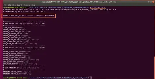

Use vi editor and open up sqlnet.ora and copy & paste the below contents into the file:
$ vi sqlnet.ora
# set trace and log parameters for client
DIAG_ADR_ENABLED=off
TRACE_UNIQUE_CLIENT=off
TRACE_TIMESTAMP_CLIENT=true
TRACE_FILELEN_CLIENT=100
TRACE_LEVEL_CLIENT=support
TRACE_DIRECTORY_CLIENT=/tmp
TRACE_FILE_CLIENT=sqlnet_client.trc
LOG_DIRECTORY_CLIENT=/tmp
LOG_FILE_CLIENT=sqlnet_client.log
# set trace and log parameters for server
TRACE_TIMESTAMP_SERVER=true
TRACE_FILELEN_SERVER=100
TRACE_LEVEL_SERVER=support
TRACE_DIRECTORY_SERVER=/tmp
TRACE_FILE_SERVER=sqlnet_server.trc
LOG_DIRECTORY_SERVER=/tmp
LOG_FILE_SERVER=sqlnet_server.log
# set TNSPING Diagnostic Parameters
TNSPING.TRACE_LEVEL=support
TNSPING.TRACE_DIRECTORY=/tmp
Issue the following commands to display the contents of sqlnet.ora file:
$ cat sqlnet.ora
enter image description here Figure-88: 'sqlnet.ora' is a profile configuration file that contain parameters used by both client and server.
Names.directory_path: This parameter specifies the order of naming methods used when a client attempts a connection to a database. Possible values include: LDAP, TNSNAMES, HOSTNAME, ONAMES, and EZCONNECT.

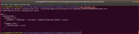

Issue the following commands to display the contents of tnsnames.ora file:
$ cat tnsnames.ora
enter image description here Figure-89: 'tnsnames.ora' file contains alias list.

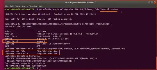

To effect the changes done on listener.ora and sqlnet.ora, reload listener by the command:
$ /oracle18c/app/oracle/product/18.0.0/dbhome_1/bin/lsnrctl reload
enter image description here Figure-90: Listener Parameters are set up successfully (compare with figure-86).

enter image description here Figure-91: Run database configuration assistance tool 'dbca'
enter image description here Figure-92: dbca logo

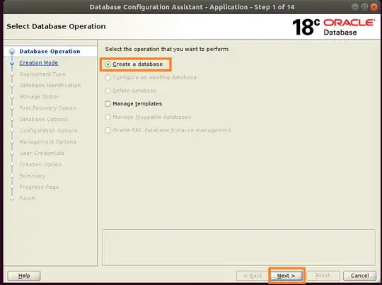

enter image description here Figure-93: Select 'Create a database operation' and press 'Next'.

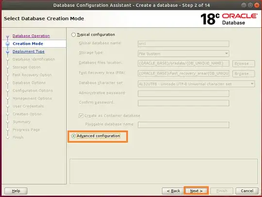

enter image description here Figure-94: Select 'Advanced configuration' mode and press 'Next'.

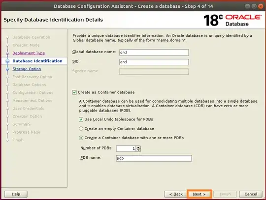

enter image description here Figure-96: Enter 'Global database name', 'SID', 'PDB name' then click 'Next' button.

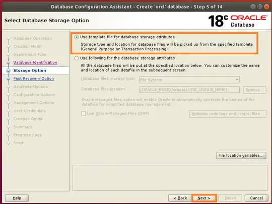

enter image description here Figure-97: Select storage option "Use template file for database storage attributes" and click 'Next'.

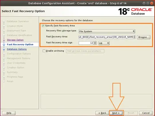

enter image description here Figure-98: Select Fast Recovery Option "Specify Fast Recovery Area" and click 'Next'

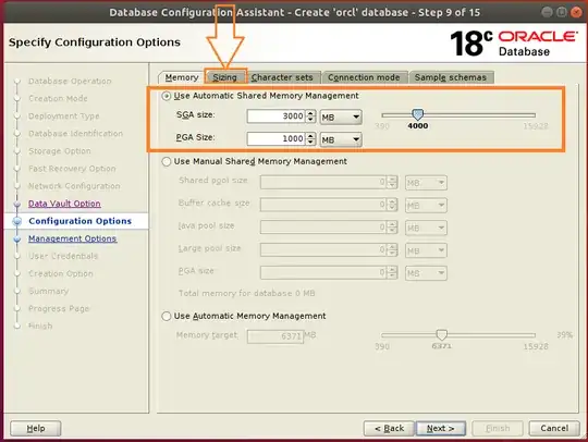

enter image description here Figure-101: Choose Memory option " Use Automatic Shared Memory Management (ASMM)" and configure "SGA" and "PGA" shared memory size and then hit menu 'Sizing'.

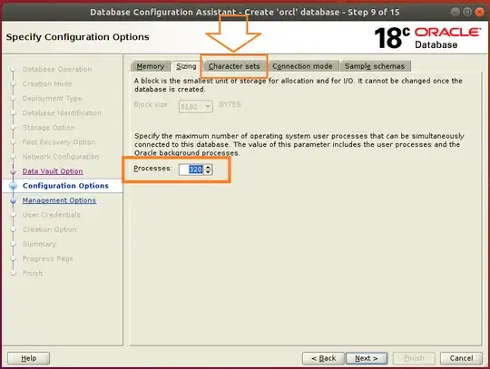

enter image description here Figure-102: Specify "Processes" Number then hit menu "Character Sets".

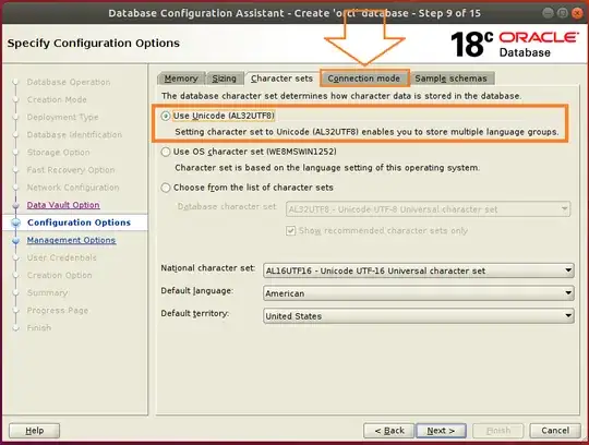

enter image description here Figure-103: Select "Unicode character" set and hit menu "Connection mode"

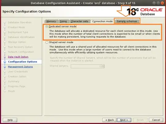

enter image description here Figure-104: Select Dedicated server mode and hit "Sample Schemas"

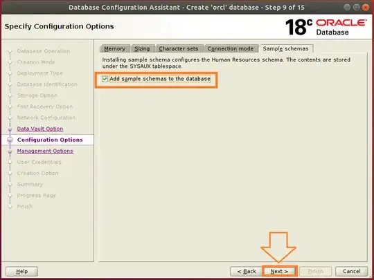

enter image description here Figure-105: Mark checkbox to "add sample schemas to the database" and then hit "Next".

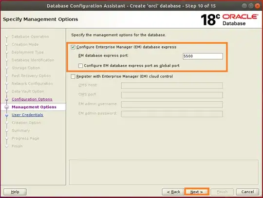

enter image description here Figure-106: Select "Configure Enterprise Manager (EM) database express " and specify port. Click 'Next'

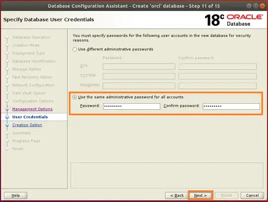

enter image description here Figure-107: Specify passwords for SYS, SYSTEM, PDBADMIN separately or select "Use the same passwords for all accounts". Click 'Next'.

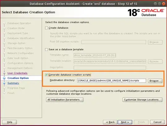

enter image description here Figure-108: Uncheck "Create database" checkbox to avoid creation of a database and check "Generate database creation scripts" checkbox. Click "Next" button.

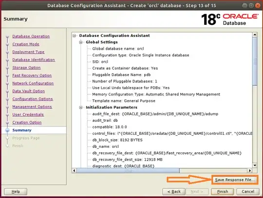

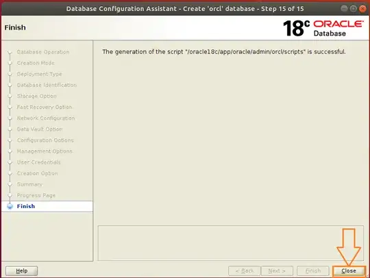

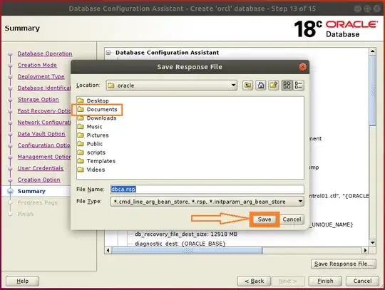

enter image description here Figure-109: Click "Save Response File " button.
enter image description here Figure-110: Double-click "Documents" folder and then save a copy of dbca.rsp file by clicking "Save" button.
Save the response file dbca.rsp in ~/Documents directory. This rsp file is needed later.
enter image description here Figure-111: After saving "dbca.rsp" file, click "Finish" button.
enter image description here Figure-112: Finish database script generation by clicking "Close" button.

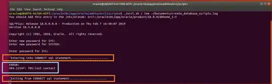

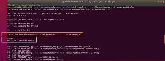

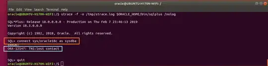

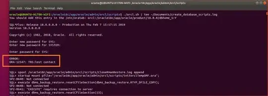

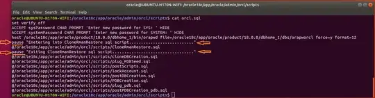

You will see the error "ORA-12547: TNS:lost contact" as shown in figure-113 given below: changes enter image description here Figure-113: "Error: ORA-12547: TNS:lost contact".
Now, we have to find out who was causing this trouble.
The shell script orcl.sh invoked orcl.sql script from where the real action began. The orcl.sql invoked a set of other sql scripts sequentially. Let us put trace statements around first sql script CloneRmanRestore.sql called by oracl.sql shown in figure-114 below:
enter image description here Figure-114: Trace statements in 'orcl.sql' file around 'CloneRmanRestore.sql' at the point of calling.

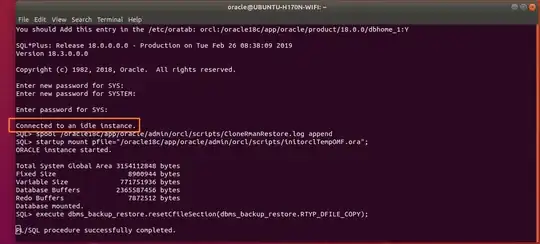

If you run orcl.sh once again, then the state of execution at the point of trace is shown below Figure-115:
enter image description here Figure-115: "Error: ORA-12547: TNS:lost contact" appears soon after entering into 'CloneRmanRestore.sql'.

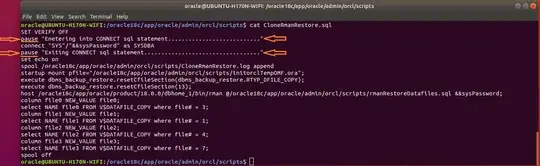

So, open up CloneRmanRestore.sql file and place trace statements around CONNECT statement which is the very first one upon entry as shown in figure-116 blow:
enter image description here Figure-116: Trace statements in 'CloneRmanRestore.sql' file around 'CONNECT' Statement.
When you run shell script orcl.sh again, the moment the state of execution enters into CloneRmanRestore.sql file, the error occurs as given in figure-117 below:
enter image description here Figure-117: Trace statements around 'CONNECT' prove that error occurred while executing 'CONNECT' statement.
It is good to know about the point of origination of error and it is the CONNECT SQL statement that caused the error. Now it is time to clean up the failed installation and redo the installation until the point of invocation of orcl.sh. So, let us go ahead with next step [section 4.3] below.

4.4.2. Install Database Software.
To install database software, follow [section 3.2] from figure-64 to figure-82.

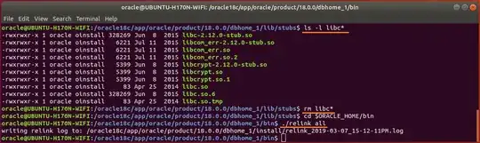

5.6. Privilege settings for oracle binary
The binary oracle should not only have 6751 privilege but also non-zero file size, as shown in figure-121 below:
$ cd $ORACLE_HOME/bin
$ ls -l oracle
enter image description here Figure-121: oracle binary has '6751' privileges set and 'non-zero' files size which are good.
If wrong privilege is set, then issue the following command:
$ chmod 6751 oracle
If oracle file shows zero file size, then issue the following command to rebuild:
$ ./relink all

5.15. Simulation of "ORA-12547: TNS:lost contact" error using sqlplus binary:
It was established that ORA-12547 error occurred while trying to create Oracle 18c Database by running scripts generated from DBCA [refer section-4.2 and figure-113]. We found out that the root cause of this error was CONNECT statement. So, let us reproduce this error again by invoking CONNECT statement directly from sqlplus binary.
Issue sqlplus command as shown below:
$ $ORACLE_HOME/bin/sqlplus /nolog
Issue CONNECT statement at SQL prompt as follows:
SQL> connect sys/oracle18c as sysdba; enter image description here Figure-129: Simulation of "ORA-12547: TNS:lost contact" error by directly invoking 'sqlplus' binary.
Now it is established that the error is re-creatable by executing sqlplus binary. In the absence of source code, we should attack the problem with whatever weapons left in our arsenal. As a first step, let us try to generate trace information describing the sequence of events taking place within sqlplus binary.

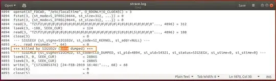

5.16. Run strace command to generate trace information needed to dig further:
In order to generate trace file needed for further investigation into CONNECT statement, let us use strace command along with sqlplus as shown below:
$ strace -f -o /tmp/strace.log $ORACLE_HOME/bin/sqlplus /nolog
enter image description here Figure-130: Use 'strace' command to investigate into 'CONNECT' statement invoked from 'sqlplus' binary.
Now, use gedit and open up /tmp/strace.log file. After tracing entire file, the problem area was identified as shown in the figure-131 below: enter image description here Figure-131: "core dump" is found recorded in the 'strace.log' file.

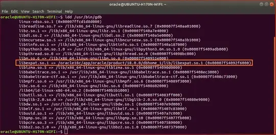

To resolve symbol lookup error, issue the following command to inspect dependancies of gdb:
$ ldd /usr/bin/gdb enter image description here Figure-138: Output shows that only shared object 'libexpat.so.1' has been loaded wrongly from '$ORACLE_HOME/lib'.
From the about output in above figure-138, one can easily deduce that the issue is connected with LD_LIBRARY_PATH environment variable.

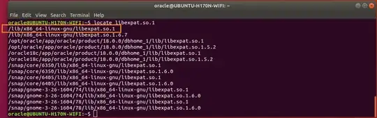

Firstly, issue the following command to locate the correct path of libexpat.so.1:
$ locate libexpat.so.1 enter image description here Figure-139: The correct library path for 'libexpat.so.1' is '/lib/x86_64-linux-gnu/'

Issue the following command once again to inspect dependency list of gdb in order to make sure that libexpat.so.1 is loaded from right path:
$ ldd /usr/bin/gdb enter image description here Figure-143: Output shows that 'libexpat.so.1' is loaded correctly from '/lib/x86_64-linux-gnu'.

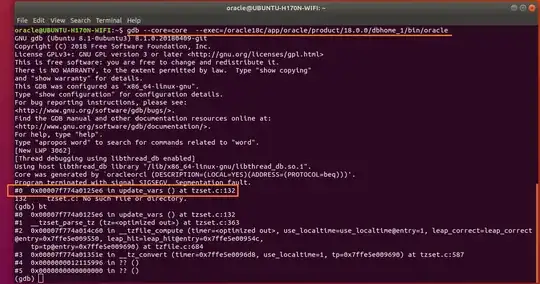

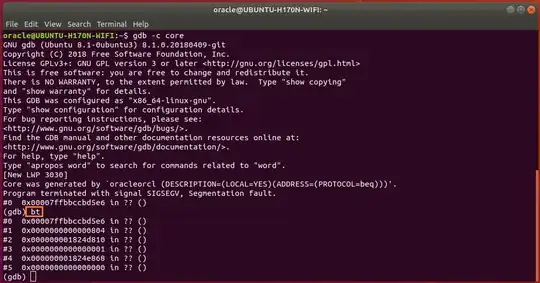

Issue bt command at gdb prompt, as shown below:
(gdb) bt enter image description here Figure-145: The screen shows the output of 'bt' command and observe that the result is too poor to analyze.
The result of bt command was too poor and we need more information for analysis. Let us attempt another method with the following command:
$ gdb --core=core --exec=/oracle18c/app/oracle/product/18.0.0/dbhome_1/bin/oracle
Issue bt command at gdb prompt:
(gdb) bt
enter image description here Figure-146: The result produced by the above command is more promising than in figure-145.
The tzset() function sets time conversion information used by localtime() and related functions. Moreover, localtime() is not thread-safe because it returns a pointer (struct tm *) to a static data structure (refer <time.h> header for more details) which holds the result. Let us review the /tmp/strace.log once again: enter image description here Figure-147: The file "/etc/localtime" was the last one accessed before crash (core dump).
The file "/etc/localtime" was the last one accessed before crash (core dump). From the beginning until core dump, this file "/etc/localtime" was accessed twice. This shows a condition of deadlock because localtime() is entered recursively (for a second time) due to some signal being handled and localtime() is not reentrant or thread-safe, so it blocks on a lock.
We can conclude that Oracle kernel is crashing in various libc functions (Standard Library for C Programming Language), e.g. localtime().

To accomplish this task, issue the following commands:
$ cd $ORACLE_HOME/lib/stubs
$ ls -l libc*
$ rm libc*
$ ./relink all
enter image description here Figure-149: Rebuild oracle kernel program "$ORACLE_HOME/bin/oracle" afresh by issuing "./relink all" command and observe the resulting log file.
After the rebuilt, inspect its log file $ORCALE_HOME/install/relink_2019-02-26_08-27.log to ensure that all rebuilds succeeded.
Run strace command once again and let us check that our arch-villain "ORA-12547: TNS:lost contact" still persists!
enter image description here Figure-150: Our arch-villain "ORA-12547: TNS:lost contact" has vanished at last and replaced by "an idle instance".
Bingo! Our arch-villain "ORA-12547: TNS:lost contact" has disappeared at last!
The connect statement was executed successfully and an idle instance was also generated.
5.17. Re-run the Scripts generated from DBCA to create Oracle 18c Database:
To display the list of scripts required to create database, issue these commands:
$ cd /oracle18c/app/oracle/admin/orcl/scripts
$ ls -l *.sql
enter image description here Figure-151: List of scripts generated by 'DBCA' required to create oracle 18c database.
Ensure that listener is already up and running with the following command:
$ ss -elpunt | grep -E "^Net|tnslsnr" | column -t
enter image description here Figure-152: Oracle listener is running and listening on port 1521.
With reference to [refer section-4.2 and figure-113], let us attempt once again to create Oracle 18c Database by running scripts generated from DBCA and let us hope that the database will be created successfully this time!
$ . orcl.sh | tee ~/Documents/create_database_scripts.log
enter image description here Figure-153: Creation of oracle 18c database has successfully begun! Notice the appearance of 'idle instance' inside redbox.
Let us see the screenshot of end of database creation below: enter image description here Figure-154: Creation of oracle 18c database has come to end successfully!
Let us see the Services supported by the Listener with the following command:
$ lsnrctl status
enter image description here Figure-155: Services supported by 'listener'.

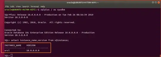

Let us verify Oracle Version with the following command:
$ sqlplus / as sysdba
SQL> select instance_name, version from v$instance;
enter image description here Figure-156: Display of Oracle Version.

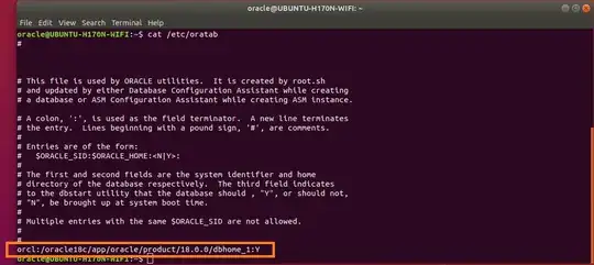

6.1. Configure /etc/oratab file.
Append "/etc/oratab" file setting the restart flag for each instance to 'Y'.
$ echo 'orcl:/oracle18c/app/oracle/product/18.0.0/dbhome_1:Y' | sudo tee -a /etc/oratab
enter image description here Figure-158: Append "/etc/oratab" file with restart flag.
Display the contents of "/etc/oratab" file with the following command:
$ cat /etc/oratab enter image description here Figure-159: Content of "/etc/oratab" file.

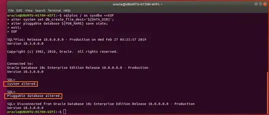

Enable Oracle Managed Files (OMF) and make sure the PDB starts when the instance starts:
$ sqlplus / as sysdba <<EOF
alter system set db_create_file_dest='${DATA_DIR}';
alter pluggable database ${PDB_NAME} save state;
exit;
EOF
enter image description here Figure-161: Pluggable database will start along with database instance.

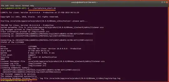

After edited the /etc/oratab (refer section-6.1), you should be able to start/stop the database with the following scripts run after logging into system as oracle user.
To start Oracle Database Service, run ora_start.sh script:
$ . ~/scripts/ora_start.sh enter image description here Figure-165: Run script 'ora_start.sh' to start database instance
To shutdown Oracle Database Service, run ora_stop.sh script:
$ . ~/scripts/ora_stop.sh enter image description here Figure-166: Run script ora_stop.sh to shut down database instance

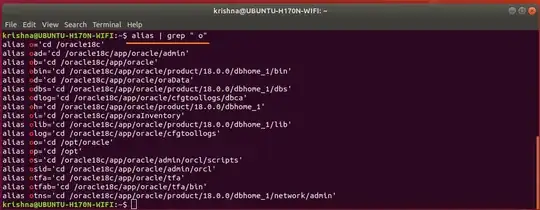

6.6. Create a list of aliases for oracle.
Create a list of aliases suitable for Oracle in ~/scripts/oalias.sh as follows:
$ vi ~/scripts/oalias.sh
Append the following into ~/scripts/oalias.sh file using copy-paste technique:
# alias list of useful commands for Oracle
alias o='cd /oracle18c'
alias op='cd /opt'
alias oo='cd /opt/oracle'
alias ob='cd /oracle18c/app/oracle'
alias oi='cd /oracle18c/app/oraInventory'
alias od='cd /oracle18c/app/oracle/oraData'
alias oh='cd /oracle18c/app/oracle/product/18.0.0/dbhome_1'
alias obin='cd /oracle18c/app/oracle/product/18.0.0/dbhome_1/bin'
alias olib='cd /oracle18c/app/oracle/product/18.0.0/dbhome_1/lib'
alias odbs='cd /oracle18c/app/oracle/product/18.0.0/dbhome_1/dbs'
alias olog='cd /oracle18c/app/oracle/cfgtoollogs'
alias odlog='cd /oracle18c/app/oracle/cfgtoollogs/dbca'
alias otfa='cd /oracle18c/app/oracle/tfa'
alias otfab='cd /oracle18c/app/oracle/tfa/bin'
alias os='cd /oracle18c/app/oracle/admin/orcl/scripts'
alias oad='cd /oracle18c/app/oracle/admin'

Now close your current terminal and open up a new terminal with Ctrl+Alt+T and issue the following command:
$ alias
enter image description here Figure-167: Very useful alias list for oracle.
You will see the list of aliases for oracle displayed on the screen.

  • Listener installation is carried out on silent mode using response file. The typical oracle response file netca_typ.rsp is capable of generating listener.ora and sqlnet.ora files only but not tnsnames.ora. So ntca_typ.rsp is wised up with additional instructions to produce tnsnames.ora automatically along with other two files.
  • listener.ora file is altered to set trace and log configuration parameters. Similarly sqlnet.ora file is also altered to set trace and log configuration parameters not only for client side but also for server side.

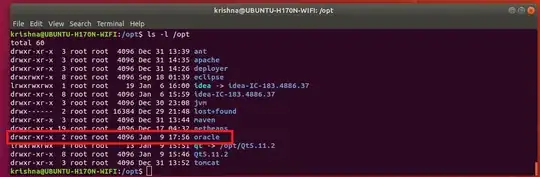

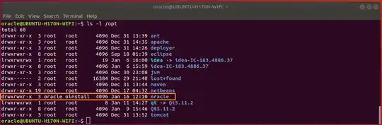

Create a folder oracle under /opt directory with the following command:
$ sudo mkdir /opt/oracle
$ ls -l /opt
enter image description here Figure-53: Directory 'oracle' under '/opt' has 'root:root' ownership.
From figure-53 above, notice that the folder /opt/oracle has root:root ownership.

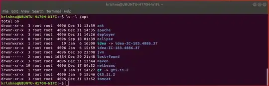

Thus, we have successfully mounted /oracle18c without compromising the ownership of /opt which still remains at root:root untouched! Of course, this is what exactly we wanted! To verify this fact, issue the following command:
$ ls -l / enter image description here Figure-56: The ownership of '/opt' partition still remains at 'root:root' untouched!
On the other hand, the ownership of oracle folder under /opt directory has automatically changed from root:root to oracle:oinstall after loading /etc/fstab changes. To verify this fact, issue the following command:
$ ls -l /opt enter image description here Figure-57: The ownership of 'oracle' folder under '/opt' partition has changed automatically from 'root:root' to 'oracle:oinstall', after loading '/etc/fstab' using 'mount -a' command.
Just compare figure-57 given above with figure-53.

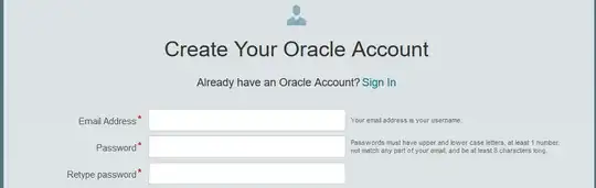

2.2.7. Create Your Oracle Account.
To download Oracle Database installation image files db_home.zip, first you should sign-up with Oracle Corporation and get a username and password. If you don’t have an account, you better sign up right now using this link: Create Oracle account enter image description here Figure-60: Create your Oracle Account
You should supply this username and password whenever you download from Oracle Website.
