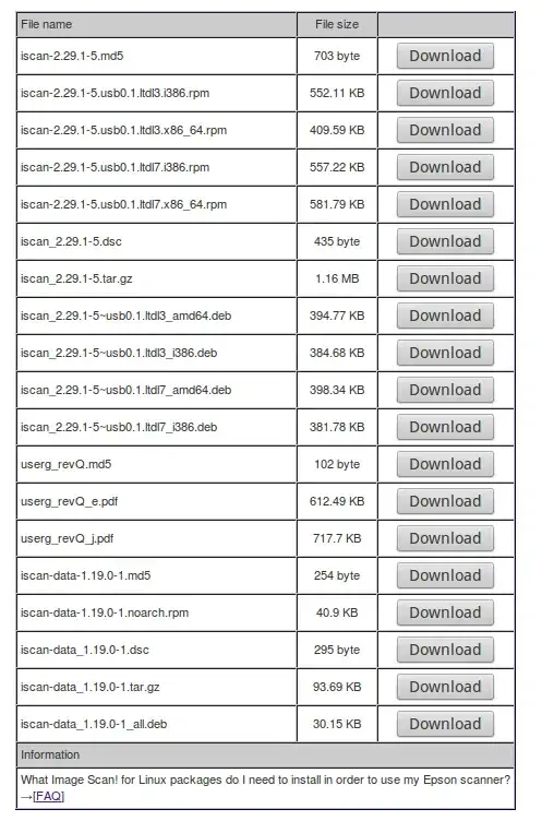

After you click accept on the driver download page for your model (V500 in this case), there are a lot of confusing options as detailed below:
1) Selecting the packages
In all cases choose the .deb files. If you are on a 32 bit system, you will need the package that has i386 in it or if you are on a 64 bit system you will need the ones with x86_64 or amd_64 in them.
You need both the data and the core packages, as noted by the FAQ.
However, it is also very important to note that if you are using an Ubuntu version that is 8.10 or higher (which mostly everyone is), you must choose the deb file that contains usb0.1.ltdl7 somewhere in its title. (The debs with usb0.1.ltdl3 in the deb title are for Ubuntu versions 8.04 and lower.)
Referring to the above screenshot, for a 32 bit system you would thus choose the following packages for your scanner:
iscan_2.29.1-5~usb0.1.ltdl7_i386.deb
iscan-data_1.19.0-1_all.deb
If you want the additional plugin (iscan-plugin-gt-x770_2.1.2-1_i386.deb for a 32 bit system), please go back to the original screen and select it.
You may also want to select the user guide for iscan; the English version is listed on the site as userg_revQ_e.pdf.

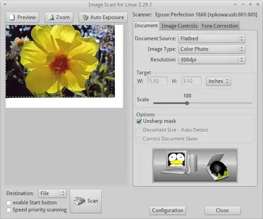

Now it's probably best to logout and login again and then switch your scanner on and go to the menu to find the iscan program in the graphics tab. Now start the program and your scanner should automatically be recognised and be ready for use.
(The example below is from another one of my scanners set up in the way described above.)
