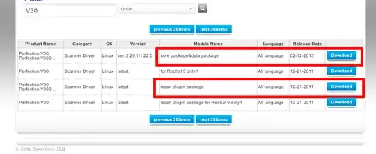

You need to install the core package/data and tje iscan plugin package. Search for V30 on this page.
