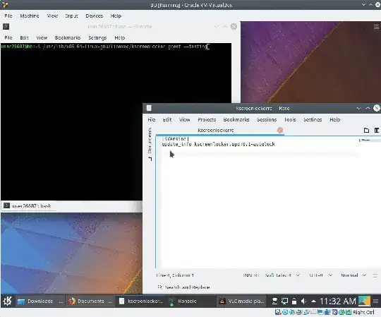

Manual configuration
The KDE screen locker configuration file is:
$ locate screenlocker
/home/<usernamehere>/.config/kscreenlockerrc
the kscreenlockerrc.
The configuration option is (true/false):
[Greeter][LnF][General]
showMediaControls=false
This can be added with the kwriteconfig5:
kwriteconfig5 --file kscreenlockerrc --group Greeter --group LnF --group General --key showMediaControls --type bool false
Testing
Without: enter image description here
With the 'false':
