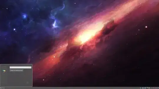

i have an... kinda odd problem with my cinnamon desktop.
After i added a new entry on the menu (using: right-click on the main menu-> configure -> goto menu tab -> open the menu editor) i looked at my menu again and didn't see any app of any kind on it (even the "all applications" menu is empty)
cinnamon menu bug
Tried to enter on the menu editor again and it doesn't work at all: doesn't show any error (visually at least, can't say the same for the console output since i don't know which program is) or shows anything on the screen
Also, installed alacarte hoping that i could do anything there. Added/Removed some items on any menu with no luck at all, looked on the ~/local/shared folder for any entry of the cinnamon menu, everything seems ok (as far as i could see)

I had a similar problem for a few days and tore my hair out over it a little, but here's what ended up working for me: open the Menu Editor (it's in the settings for the Menu applet), and deselect the "Other" category. I have no idea why this ended up working, but it did. Also, for some reason, all of the programs under the "Wine" and "Universal Access" categories got moved to "Other", so I had to move the ones I actually cared about back.
