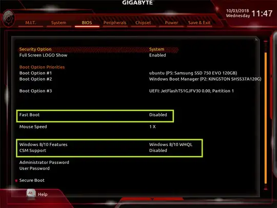

enter image description here Figure-2: A typical BIOS setup with a sequence of bootloaders

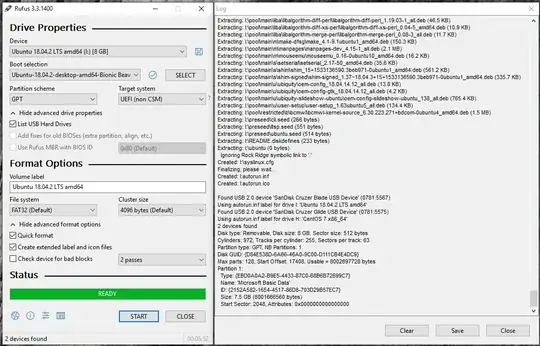

Procedure to prepare bootable USB stick for Bionic Beaver using Rufus:
  1. Click “Select” in order to browse the location of Ubuntu ISO file and select the same.
  2. Set “Partition scheme” to “GPT” which is the default partition scheme for UEFI computer.
  3. Select “Target system” as “UEFI (non CSM).
  4. Set “New Volume Label” as “Ubuntu 18.04.2 LTS amd64”.
  5. Select “File system” to be “FAT32 (default)”.
  6. Set “Cluster size” to “4096 bytes (default)”
  7. Enable “Quick format” and select “2 passes” as show in the screenshot below.
  8. Make sure that Rufus hasn’t changed the partitioning scheme after you have selected the ISO.
  9. Click Start button to prepare bootable Ubuntu USB stick.
enter image description here Figure-3: Ubuntu 18.04.02 Bionic Beaver

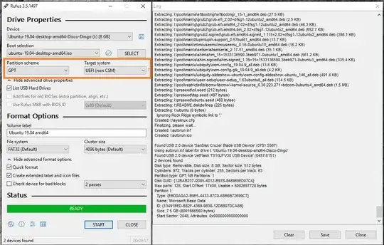

Procedure to prepare bootable USB stick for Disco Dingo using Rufus:
Please follow suit the same procedure for Bionic Beaver as given above except for two changes step-1 and step-4:
  • Step-1: Browse for Ubuntu 19.04 LTS amd64 ISO file and select the same.
  • Step-4: Set “New Volume Label” as “Ubuntu 19.04 amd64”.
enter image description here Figure-4: Ubuntu 19.04 Disco Dingo
When Rufus is ready, you will have your USB stick with a UEFI bootloader. Booting a machine with this stick allows you to boot Ubuntu 18.04.02 LTS live session so that you have access to all default Ubuntu utilities. Ubuntu ISO files can be downloaded from the following URL: http://releases.ubuntu.com

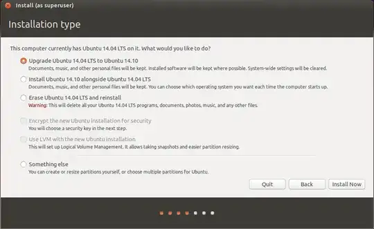

How can I upgrade ubuntu using bootable USB?
You just need to access bios of your PC, and boot from bootable USB, then select "install Ubuntu"
Then a bunch of options will appear (see the image below). Select "upgrade ubuntu" . Done
enter image description here Figure-5: Installation type
