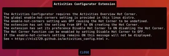

Update: May it be related to this message that occurred on my screen today?

You're using the 'Activities Configurator' GNOME shell extension evident from the screenshot. To work properly the extension needs the 'Activities Overview Hot Corner' option in Tweaks turned on.
So launch Tweaks and enable the 'Activities Overview Hot Corner' option. Then go to the 'Extensions' section and open the settings for Activities Configurator. Disable the 'Activities Overview Hot Corner' option from here.
