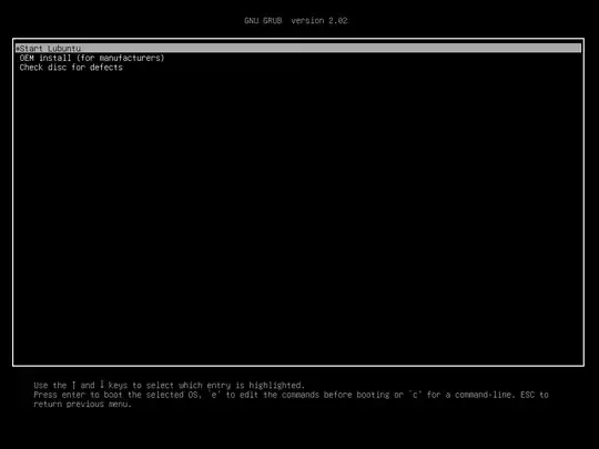

First boot: getting into GRUB: Some distributions boot into GRUB and allow you to edit options before booting in. For others, there are multiple variations of entering GRUB. I have come across pressing TAB, pressing ESC at the exact nano second, and a few others.

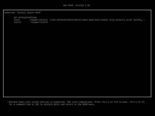

Editing GRUB
Once there, press e to edit configuration.
There should be quiet splash located there, and right after it type nouveau.modeset=0, then it should boot fine. quiet splash was removed for visibility in the screenshot.

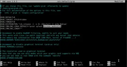

Have nouveau.modeset=0 enabled every boot
Open terminal and type sudo nano /etc/default/grub
On the line beginning with GRUB_CMDLINE_LINUX_DEFAULT=, add nouveau.modeset=0 within the quotes. CTRL + O to save, enter, CTRL + X, then type sudo update-grub into terminal.
