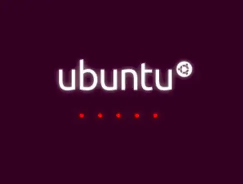

Today I switched on my laptop and ubuntu 18.04 stuck on the purple loading screen after boot. As I have another ubuntu boot on my drive, I boot into it and everything was working normally.
it boots on recovery mode.
How do I solve it?
