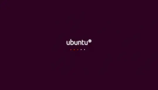

I installed Ubuntu 18.04 from a bootable USB last night, but when I tried to login to the operating system I got stuck at a ubuntu loading screen with five dots on it.
I have seen an older question where it might seem to be a graphics problem, and the solution mentioned was to press Ctrl +Alt+f1,f2,f3 etc. to go the shell, but when I do that the shell is not showing up.
What else can I try?

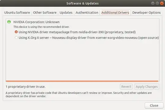

The similar stuck issue occurs when I try to restart or shutdown the system after a new installation of ubuntu 18.04.2 on my laptop.
I solved the problem by switch from Nouveau driver to Nvidia driver, using Software & Updates App, as following screenshot. The problem disappers after using Nvidia driver, so I assume there are some potential bugs in Nouveau driver.
Just for references, here is my video card info:
