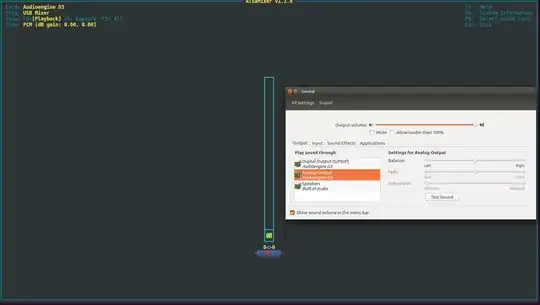

In a nut shell, the problem here is that volume slider in sound doesn't map correctly to alsamixer's volume for AudioEngine D3 USB DAC. The entire volume range in alsamixer is only mapped to a very small portion on sound's volume slide.
slider at 0% slider at 0%
slider at 100% slider at 100%
Please see below for the output of pactl list short sinks.
