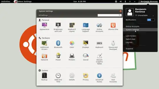

I believe maximising your volume could be achieved in the following steps:
  1. Go to System Settings through the User Indicator on Top Far Right.
  2. Select Sound in System Settings
  3. At the top of the Sound Diaglog toggle your volume past the 100% mark to a setting that meets your needs.
I have attached the following screenshot to assist you: !System Settings/Soundhttps://i.sstatic.net/j5Xfq.png
