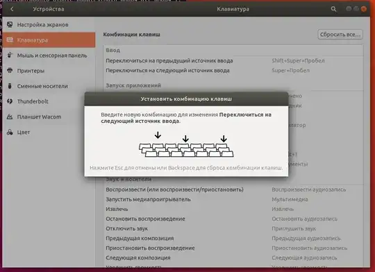

From what I remember - in 18.04.1 the interface for switching the layout was different (not the same as now in 18.04.2). And there I switched the layout keys without any problems. And now, on the new system, the new menu asks for "Enter a new combination" but does not respond to pressing Alt+Shift (or Shift+Alt). enter image description here

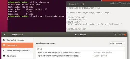

From the question-answer on SuperUser, I learned that you can edit the keyboard configuration file. I'll do it. I just have a file with working Alt+Shift from the first system (18.04.1-up-18.04.2).
But I also noticed that in both cases the graphical menu shows that input switching takes place via Shift+Super+Space (and Super+Space) and in both cases it works. But Alt+Shift also works on the system 18.04.1-up-18.04.2, but the graphic menu does not inform the user about this (as it was in the “previous-old-18.04.1” graphic menu).
18.04.1-up-18.04.2: 18.04.1-up-18.04.2
18.04.2: 18.04.2 Is it possible now to set the switching of the input language to Alt + Shift using the graphical menu in the clean system 18.04.2 and without installing additional software?
