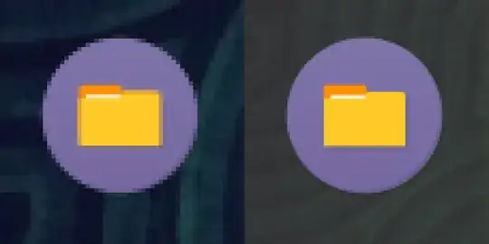

The Dock
Closeup comparison of a launcher icon in the dock. Left is 100% scaling, right is 200% scaling. The left half has been scaled up x2 in gimp for comparison purposes.
Not much to add here. As you can see, the icon has visibly more detail with 200% scaling.

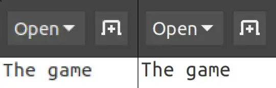

Gedit
Closeup comparison of chrome and text body of the standard text editor. Left is 100% scaling, right is 200% scaling. The left half has been scaled up x2 in gimp for comparison purposes.
Icons, labels and text body are all rendered with visibly more detail.

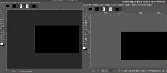

Gimp
Comparison of GIMP, a foss image manipulation program. Left is 100% scaling, right is 200% scaling.
Here it gets funny. Text elements are all rendered at twice the size, as expected. The icons however, are not, which might make them potentially too small to use on a very high dpi screen, despite the scaling. Notable is that the size of the image preview is not affected by the 200% scaling, which is certainly correct behaviour.
