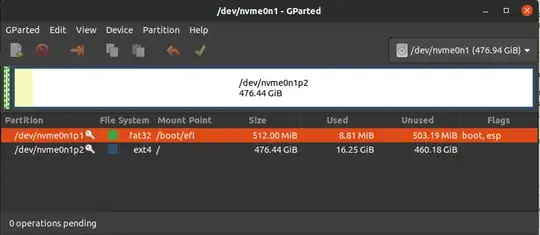

In my case, what I did, is the first time during installation by selecting the Option Erase disk and install Ubuntu, and I got the same error.
Then, I saw somewhere saying to select the option Something else and from there, I created:
- Small partition of 500MB 'EFI System Partition' as Primary' as explained earlier and (you might need to delete it and then re-create it)
- Created a ext4 partition to use all remaining disk space as root /
Here is the example of how it looks like at the end
Then continued with installation, and surprisingly, it worked!
