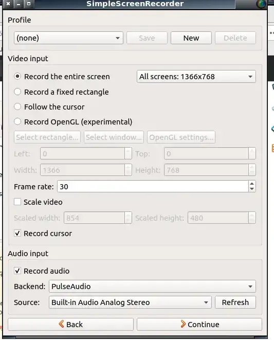

A simple one is simplescreenrecorder which can be found in the 18.04 repo. Install it with
sudo apt install simplescreenrecorder
start it > Continue > choose size of screen to record > tick the box for audio. For Backend choose pulseaudio. For source choose built in audio analogue stereo which would record the mic instead of the internal audio > choose save location and the default codec parameters should be ok

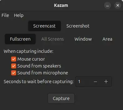

There is an application in the Official Ubuntu Software Repository callled Kazam, which works great. It will record internal sound, external sound, and the screen. It has pretty good video quality, as well. It can be installed with:
$ sudo apt-get install kazam
If your recording doesn't have microphone sound, make sure to check File > Preferences and try another "Microphone" selection, it may be picking up an unconnected headphone:
The keyboard shortcuts are:

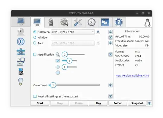

Vokoscreen
This is another decent option, it has good options and defaults:
sudo apt install vokoscreen-ng
vokoscreenNG
Present e.g. on Ubuntu 24.10 and earlier.
Unfortunately I've had a little bit of choppy audio issues recently.
