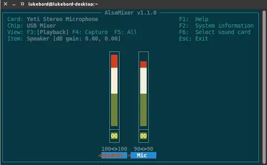

I also checked alsamixer, which is showing my microphone fine.

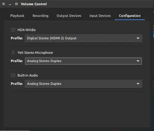

I tried changing settings up pavucontrol, but the microphone is set to Analog Stereo Duplex which is what other posts on here said to double check.

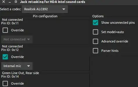

Lastly, I tried overriding pin 0x12 in hdajackretask to no avail.
