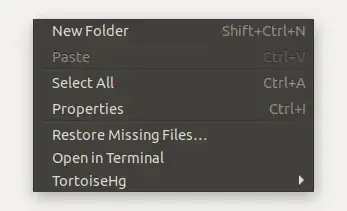

I'm having the same issue with RabbitVCS as this post: Rabbit VCS on Ubuntu 18.04 - not showing menu in Nautilus. However, I've followed the accepted answer and the comments, and I still do not get the RabbitVCS context menu.
UPDATE: Below are the results of the commands from the other post that I followed. Also, if it makes a difference, I'm running inside VirtualBox.
