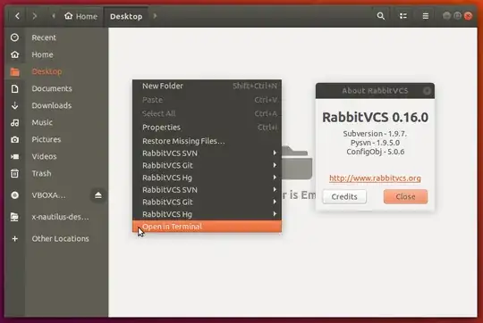

RabbitVCS on Nautilus 3.26 in Ubuntu 18.04 LTS
I hope it is fully-functional.
Notes:
1. if you need only Mercurial you can use tortoisehg-nautilus package.
2. if you see two RabbitVCS menu sections then remove python extension from home folder with rm ~/.local/share/nautilus-python/extensions/RabbitVCS.py.
