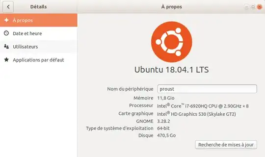

I don't undestand why my Ubuntu 18.04 reports 11.8Gb instead of expected +/-32Gb.
I have 2 physical "pieces" of 16Gb RAM each on a Dell laptop Precision 7510.
OS is 64 bits:
$ lsb_release -a
No LSB modules are available.
Distributor ID: Ubuntu
Description:    Ubuntu 18.04.1 LTS
Release:    18.04
Codename:   bionic

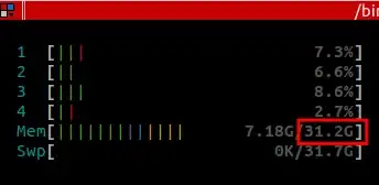

Ubuntu reports 11.8Gb, command htop reports 11.8Gb of max RAM.

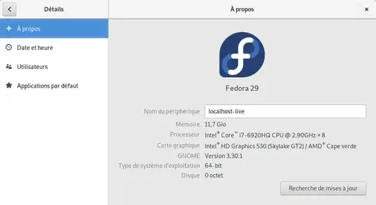

I booted on a Live Fedora 29 from a USB key.
Result looks the same, only 12Gb available for OS:
htop result on Fedora
htop fedora
Fedora OS details window

[    0.000000] x86/fpu: Enabled xstate features 0x1f, context size is 960 bytes, using 'compacted' format.
[    0.000000] BIOS-provided physical RAM map:
[    0.000000] BIOS-e820: [mem 0x0000000000000000-0x000000000009dbff] usable
[    0.000000] BIOS-e820: [mem 0x000000000009dc00-0x000000000009ffff] reserved
[    0.000000] BIOS-e820: [mem 0x00000000000e0000-0x00000000000fffff] reserved
[    0.000000] BIOS-e820: [mem 0x0000000000100000-0x0000000066540fff] usable
[    0.000000] BIOS-e820: [mem 0x0000000066541000-0x0000000066541fff] ACPI NVS
[    0.000000] BIOS-e820: [mem 0x0000000066542000-0x000000006b7a2fff] reserved
[    0.000000] BIOS-e820: [mem 0x000000006b7a3000-0x000000006b7dffff] ACPI data
[    0.000000] BIOS-e820: [mem 0x000000006b7e0000-0x000000006be59fff] ACPI NVS
[    0.000000] BIOS-e820: [mem 0x000000006be5a000-0x000000006fffffff] reserved
[    0.000000] BIOS-e820: [mem 0x00000000e0000000-0x00000000efffffff] reserved
[    0.000000] BIOS-e820: [mem 0x00000000fe000000-0x00000000fe010fff] reserved
[    0.000000] BIOS-e820: [mem 0x00000000fec00000-0x00000000fec00fff] reserved
[    0.000000] BIOS-e820: [mem 0x00000000fee00000-0x00000000fee00fff] reserved
[    0.000000] BIOS-e820: [mem 0x00000000ff000000-0x00000000ffffffff] reserved
[    0.000000] BIOS-e820: [mem 0x0000000100000000-0x000000039b2dcfff] usable
[    0.000000] BIOS-e820: [mem 0x000000039b2dd000-0x000000088dffffff] reserved
[    0.000000] NX (Execute Disable) protection: active
[    0.000000] SMBIOS 3.0.0 present.
[    0.000000] DMI: Dell Inc. Precision 7510/0M1YNP, BIOS 1.16.3 09/12/2018
[    0.000000] e820: update [mem 0x00000000-0x00000fff] usable ==> reserved
[    0.000000] e820: remove [mem 0x000a0000-0x000fffff] usable
[    0.000000] last_pfn = 0x39b2dd max_arch_pfn = 0x400000000
[    0.000000] MTRR default type: write-back
[    0.000000] MTRR fixed ranges enabled:
[    0.000000]   00000-9FFFF write-back
[    0.000000]   A0000-BFFFF uncachable
[    0.000000]   C0000-FFFFF write-protect
[    0.000000] MTRR variable ranges enabled:
[    0.000000]   0 base 0080000000 mask 7F80000000 uncachable
[    0.000000]   1 base 0070000000 mask 7FF0000000 uncachable
[    0.000000]   2 base 006E000000 mask 7FFE000000 uncachable
[    0.000000]   3 base 006D800000 mask 7FFF800000 uncachable
[    0.000000]   4 disabled
[    0.000000]   5 disabled
[    0.000000]   6 disabled
[    0.000000]   7 disabled
[    0.000000]   8 disabled
[    0.000000]   9 disabled
[    0.000000] x86/PAT: Configuration [0-7]: WB  WC  UC- UC  WB  WP  UC- WT
[    0.000000] last_pfn = 0x66541 max_arch_pfn = 0x400000000
[    0.000000] found SMP MP-table at [mem 0x000fce40-0x000fce4f] mapped at [(____ptrval____)]
[    0.000000] Base memory trampoline at [(____ptrval____)] 97000 size 24576
[    0.000000] Using GB pages for direct mapping
[    0.000000] BRK [0x348aaf000, 0x348aaffff] PGTABLE
[    0.000000] BRK [0x348ab0000, 0x348ab0fff] PGTABLE
[    0.000000] BRK [0x348ab1000, 0x348ab1fff] PGTABLE
[    0.000000] BRK [0x348ab2000, 0x348ab2fff] PGTABLE
[    0.000000] BRK [0x348ab3000, 0x348ab3fff] PGTABLE
[    0.000000] BRK [0x348ab4000, 0x348ab4fff] PGTABLE
[    0.000000] BRK [0x348ab5000, 0x348ab5fff] PGTABLE
[    0.000000] BRK [0x348ab6000, 0x348ab6fff] PGTABLE
[    0.000000] RAMDISK: [mem 0x63526000-0x66540fff]
[    0.000000] ACPI: Early table checksum verification disabled
[    0.000000] ACPI: RSDP 0x00000000000E98B0 000024 (v02 DELL  )
[    0.000000] ACPI: XSDT 0x000000006B7AF0B0 0000DC (v01 DELL   CBX3     01072009 AMI  00010013)
[    0.000000] ACPI: FACP 0x000000006B7D0780 00010C (v05 DELL   CBX3     01072009 AMI  00010013)
[    0.000000] ACPI: DSDT 0x000000006B7AF218 021568 (v02 DELL   CBX3     01072009 INTL 20120913)
[    0.000000] ACPI: FACS 0x000000006BE57E80 000040
[    0.000000] ACPI: APIC 0x000000006B7D0890 0000BC (v03 DELL   CBX3     01072009 AMI  00010013)
[    0.000000] ACPI: FPDT 0x000000006B7D0950 000044 (v01 DELL   CBX3     01072009 AMI  00010013)
[    0.000000] ACPI: MCFG 0x000000006B7D0998 00003C (v01 DELL   CBX3     01072009 MSFT 00000097)
[    0.000000] ACPI: HPET 0x000000006B7D09D8 000038 (v01 DELL   CBX3     01072009 AMI. 0005000B)
[    0.000000] ACPI: SSDT 0x000000006B7D0A10 00046D (v01 SataRe SataTabl 00001000 INTL 20120913)
[    0.000000] ACPI: LPIT 0x000000006B7D0E80 000094 (v01 INTEL  SKL      00000000 MSFT 0000005F)
[    0.000000] ACPI: SSDT 0x000000006B7D0F18 000248 (v02 INTEL  sensrhub 00000000 INTL 20120913)
[    0.000000] ACPI: SSDT 0x000000006B7D1160 002BAE (v02 INTEL  PtidDevc 00001000 INTL 20120913)
[    0.000000] ACPI: SSDT 0x000000006B7D3D10 0007D9 (v02 INTEL  xh_rvp07 00000000 INTL 20120913)
[    0.000000] ACPI: DBGP 0x000000006B7D44F0 000034 (v01 INTEL           00000000 MSFT 0000005F)
[    0.000000] ACPI: DBG2 0x000000006B7D4528 000054 (v00 INTEL           00000000 MSFT 0000005F)
[    0.000000] ACPI: SSDT 0x000000006B7D4580 003866 (v02 SaSsdt SaSsdt   00003000 INTL 20120913)
[    0.000000] ACPI: UEFI 0x000000006B7D7DE8 000042 (v01                 00000000      00000000)
[    0.000000] ACPI: SSDT 0x000000006B7D7E30 000E73 (v02 CpuRef CpuSsdt  00003000 INTL 20120913)
[    0.000000] ACPI: SSDT 0x000000006B7D8CA8 00435D (v02 DptfTa DptfTabl 00001000 INTL 20120913)
[    0.000000] ACPI: MSDM 0x000000006B7DD008 000055 (v03 DELL   CBX3     06222004 AMI  00010013)
[    0.000000] ACPI: SLIC 0x000000006B7DD060 000176 (v03 DELL   CBX3     01072009 MSFT 00010013)
[    0.000000] ACPI: SSDT 0x000000006B7DD1D8 000094 (v02 SgRef  SgPeg    00001000 INTL 20120913)
[    0.000000] ACPI: DMAR 0x000000006B7DD270 0000A8 (v01 INTEL  SKL      00000001 INTL 00000001)
[    0.000000] ACPI: TPM2 0x000000006B7DD318 000034 (v03        Tpm2Tabl 00000001 AMI  00000000)
[    0.000000] ACPI: SSDT 0x000000006B7DD350 000F00 (v01 AmdRef AmdTabl  00001000 INTL 20120913)
[    0.000000] ACPI: ASF! 0x000000006B7DE250 0000A5 (v32 INTEL   HCG     00000001 TFSM 000F4240)
[    0.000000] ACPI: Local APIC address 0xfee00000
[    0.000000] No NUMA configuration found
[    0.000000] Faking a node at [mem 0x0000000000000000-0x000000039b2dcfff]
[    0.000000] NODE_DATA(0) allocated [mem 0x39b2b2000-0x39b2dcfff]
[    0.000000] Zone ranges:
[    0.000000]   DMA      [mem 0x0000000000001000-0x0000000000ffffff]
[    0.000000]   DMA32    [mem 0x0000000001000000-0x00000000ffffffff]
[    0.000000]   Normal   [mem 0x0000000100000000-0x000000039b2dcfff]
[    0.000000]   Device   empty
[    0.000000] Movable zone start for each node
[    0.000000] Early memory node ranges
[    0.000000]   node   0: [mem 0x0000000000001000-0x000000000009cfff]
[    0.000000]   node   0: [mem 0x0000000000100000-0x0000000066540fff]
[    0.000000]   node   0: [mem 0x0000000100000000-0x000000039b2dcfff]
[    0.000000] Reserved but unavailable: 26694 pages
[    0.000000] Initmem setup node 0 [mem 0x0000000000001000-0x000000039b2dcfff]
[    0.000000] On node 0 totalpages: 3151802
[    0.000000]   DMA zone: 64 pages used for memmap
[    0.000000]   DMA zone: 21 pages reserved
[    0.000000]   DMA zone: 3996 pages, LIFO batch:0
[    0.000000]   DMA32 zone: 6486 pages used for memmap
[    0.000000]   DMA32 zone: 415041 pages, LIFO batch:31
[    0.000000]   Normal zone: 42700 pages used for memmap
[    0.000000]   Normal zone: 2732765 pages, LIFO batch:31
[    0.000000] Reserving Intel graphics memory at [mem 0x6e000000-0x6fffffff]
[    0.000000] ACPI: PM-Timer IO Port: 0x1808
[    0.000000] ACPI: LAPIC_NMI (acpi_id[0x01] high edge lint[0x1])
[    0.000000] ACPI: LAPIC_NMI (acpi_id[0x02] high edge lint[0x1])
[    0.000000] ACPI: LAPIC_NMI (acpi_id[0x03] high edge lint[0x1])
[    0.000000] ACPI: LAPIC_NMI (acpi_id[0x04] high edge lint[0x1])
[    0.000000] ACPI: LAPIC_NMI (acpi_id[0x05] high edge lint[0x1])
[    0.000000] ACPI: LAPIC_NMI (acpi_id[0x06] high edge lint[0x1])
[    0.000000] ACPI: LAPIC_NMI (acpi_id[0x07] high edge lint[0x1])
[    0.000000] ACPI: LAPIC_NMI (acpi_id[0x08] high edge lint[0x1])
[    0.000000] IOAPIC[0]: apic_id 2, version 32, address 0xfec00000, GSI 0-119
[    0.000000] ACPI: INT_SRC_OVR (bus 0 bus_irq 0 global_irq 2 dfl dfl)
[    0.000000] ACPI: INT_SRC_OVR (bus 0 bus_irq 9 global_irq 9 high level)
[    0.000000] ACPI: IRQ0 used by override.
[    0.000000] ACPI: IRQ9 used by override.
[    0.000000] Using ACPI (MADT) for SMP configuration information
[    0.000000] ACPI: HPET id: 0x8086a701 base: 0xfed00000
[    0.000000] smpboot: Allowing 8 CPUs, 0 hotplug CPUs
[    0.000000] PM: Registered nosave memory: [mem 0x00000000-0x00000fff]
[    0.000000] PM: Registered nosave memory: [mem 0x0009d000-0x0009dfff]
[    0.000000] PM: Registered nosave memory: [mem 0x0009e000-0x0009ffff]
[    0.000000] PM: Registered nosave memory: [mem 0x000a0000-0x000dffff]
[    0.000000] PM: Registered nosave memory: [mem 0x000e0000-0x000fffff]
[    0.000000] PM: Registered nosave memory: [mem 0x66541000-0x66541fff]
[    0.000000] PM: Registered nosave memory: [mem 0x66542000-0x6b7a2fff]
[    0.000000] PM: Registered nosave memory: [mem 0x6b7a3000-0x6b7dffff]
[    0.000000] PM: Registered nosave memory: [mem 0x6b7e0000-0x6be59fff]
[    0.000000] PM: Registered nosave memory: [mem 0x6be5a000-0x6fffffff]
[    0.000000] PM: Registered nosave memory: [mem 0x70000000-0xdfffffff]
[    0.000000] PM: Registered nosave memory: [mem 0xe0000000-0xefffffff]
[    0.000000] PM: Registered nosave memory: [mem 0xf0000000-0xfdffffff]
[    0.000000] PM: Registered nosave memory: [mem 0xfe000000-0xfe010fff]
[    0.000000] PM: Registered nosave memory: [mem 0xfe011000-0xfebfffff]
[    0.000000] PM: Registered nosave memory: [mem 0xfec00000-0xfec00fff]
[    0.000000] PM: Registered nosave memory: [mem 0xfec01000-0xfedfffff]
[    0.000000] PM: Registered nosave memory: [mem 0xfee00000-0xfee00fff]
[    0.000000] PM: Registered nosave memory: [mem 0xfee01000-0xfeffffff]
[    0.000000] PM: Registered nosave memory: [mem 0xff000000-0xffffffff]
[    0.000000] [mem 0x70000000-0xdfffffff] available for PCI devices
[    0.000000] Booting paravirtualized kernel on bare hardware
[    0.000000] clocksource: refined-jiffies: mask: 0xffffffff max_cycles: 0xffffffff, max_idle_ns: 1910969940391419 ns
[    0.000000] random: get_random_bytes called from start_kernel+0x93/0x558 with crng_init=0
[    0.000000] setup_percpu: NR_CPUS:1024 nr_cpumask_bits:8 nr_cpu_ids:8 nr_node_ids:1
[    0.000000] percpu: Embedded 45 pages/cpu @(____ptrval____) s147456 r8192 d28672 u262144
[    0.000000] pcpu-alloc: s147456 r8192 d28672 u262144 alloc=1*2097152
[    0.000000] pcpu-alloc: [0] 0 1 2 3 4 5 6 7
[    0.000000] Built 1 zonelists, mobility grouping on.  Total pages: 3102531
[    0.000000] Policy zone: Normal
[    0.000000] Kernel command line: BOOT_IMAGE=vmlinuz initrd=initrd.img root=live:CDLABEL=Fedora-WS-Live-29-1-2 rd.live.image rd.live.check quiet
[    0.000000] Memory: 12264216K/12607208K available (12300K kernel code, 1624K rwdata, 4056K rodata, 2160K init, 1336K bss, 342992K reserved, 0K cma-reserved)

After changing the physical memory sticks, (replaced 2 old of 16Go per 4 of 8Go) I now have 31.2 Go detected.
Thus, it was a physical memory problem.
and also, with htop:
