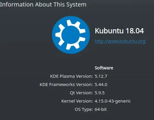

It looks like a bug but I am not sure which program is to blame..
In Plasma 5.12 the option to add global menus in window titlebar has been removed, but there is a panel widget that adds global menus to the panel, while global menus are still available in the window titlebar as a button.

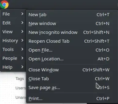

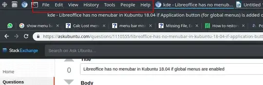

"Global Menu" widget on the panel (Chrome menu):

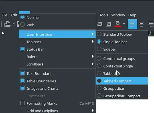

Setting as indicated here (under System Settings > Application Style > Windows Decorations > (tab) Buttons)
brings global menus into a left-side button on the window upper margin; like for example in Chrome:

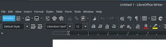

When any of these global menus are enabled, Libreoffice (6.0.7) has no menubar anymore. Adding the Menubar button in Libreoffice and using it has no effect.
But after disabling these two ways of displaying global menus, the menubar in Libreoffice comes back. These changes happen instantly in Libreoffice, no program restart needed.
So, it seems I cannot enjoy global menus and use Libreoffice properly in Kubuntu 18.04.

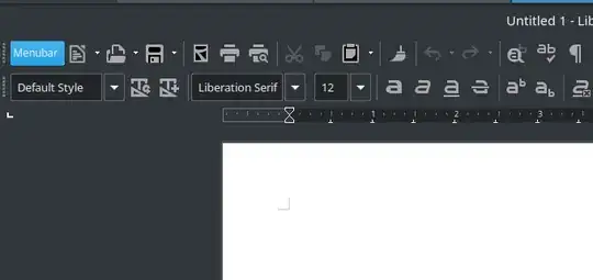

Just install libreoffice-kde
sudo apt install libreoffice-kde

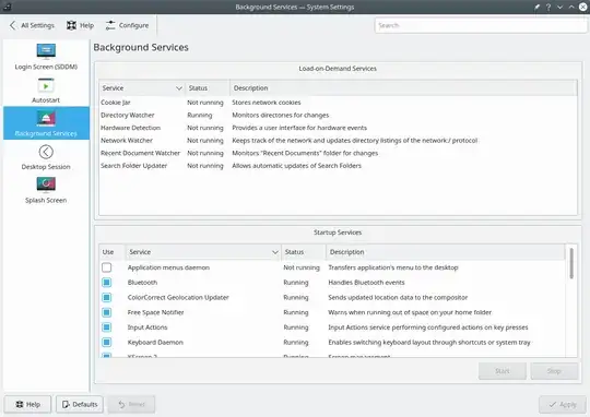

Years later, I stumbled against the same problem and found an answer here. It worked for me. I don't take credit for this, but rather post it than forget it next time I reinstall.
The idea is to search for the Background Services and disable the Application menus daemon.

Workaround: while this will not bring the standard menubar (when global menus are enabled as indicated in the question), it will make Libreoffice usable by providing access to its menus in one of the user interfaces that become available if experimental features are enabled.
Global menus have to be disabled (as panel widget or as window button) in order to access Libreoffice menus of the standard interface.

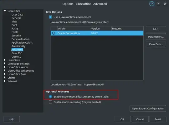

Enable experimental features under Tools - Options - Advanced.
Note: You can access the Options window by pressing Alt + F12

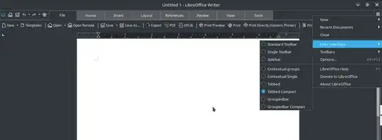

Then go to View - User interface and select of the UIs from the lower part of the list.
Each of them is different (somewhat similar to the different versions of msoffice), but they all provide access to the menus in various forms. For example, the "Tabbed compact" UI provides menus in tabs and shows a button to the right-upper corner to access among others the different UIs.
