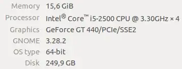

System info: Ubuntu 18.04.1 LTS, GNOME 3.28.2.
system info

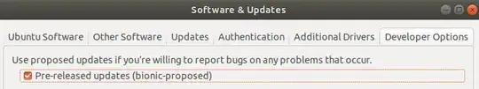

Until is added to normal repos, to enable them on Bionic (18.04) as said here, follow these instructions to enable the proposed archive, which basically say:
  1. Enable pre-release updates: emphasized text
