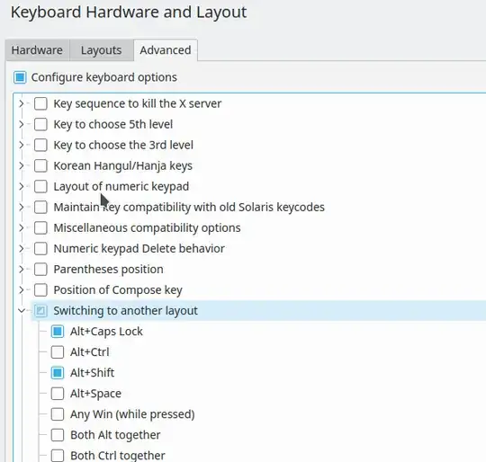

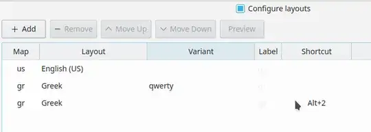

which does not made any major difference in my DE. I have also tried from KDE System Settings > Input Devices > Keyboard > Layouts tab enter image description here
At present I have 3 languages in my keyboard layout switcher:
English (US)
Greek (qwerty)
Greek (Greek).
Although I see the 3 options (only with right click though which I am not sure it's the default behavior) I cannot choose a different than the default (English) either by mouse or by keyboard.
I added 2 keyboard shortcuts to change layouts but to no avail. enter image description here

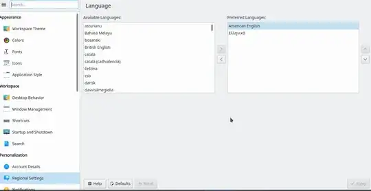

In the Regional Settings I have added Greek also enter image description here

After a lot of research I managed to overcome the problem by a somewhat bizarre solution. At least in my case the system seemed to be able to toggle between English and Greek after this approach.
  • I added a 3rd language in the Configure layout... (in my case Spanish)
  • Enable Spare layouts
  • Also (I am not sure this is necessary but I followed that step also) I installed the 3rd language to Regional Settings dialog.
  • After logout I was able to use the keyboard shortcut.
The funny thing is that I removed the 3rd language after that and it still works (I only kept English and Greek which was my initial intention).

In system settings/input devices/keyboard/layout I first clicked on the middle square and then added the Greek Lang. Then up right I set the "Change layout shortcut" to the one I preferred
