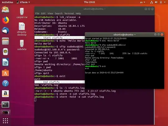

Type exit to leave script and viafifo. After that you can get a log file with the whole dialogue.

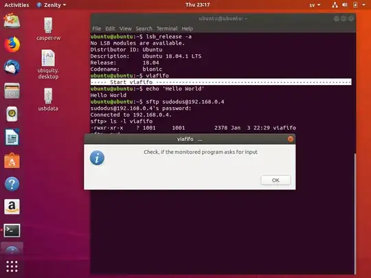

#   zenity --notification --text="$message" 2> /dev/null
   espeak "$message" &
   zenity --info --title="${0##*/} ${1##*/} $2 ..." \
    --text="$message" --width=500  2> /dev/null

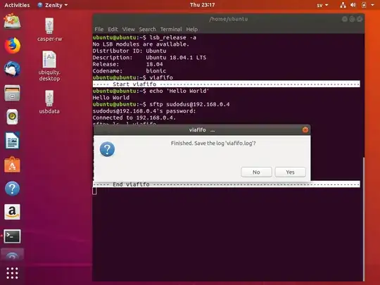

savlog="Finished. Save the log '${name}.log'?"
espeak "$savlog" &
zenity --question --title="${0##*/} ${1##*/} $2 ..." \
    --text="$savlog" --width=500  2> /dev/null

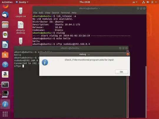

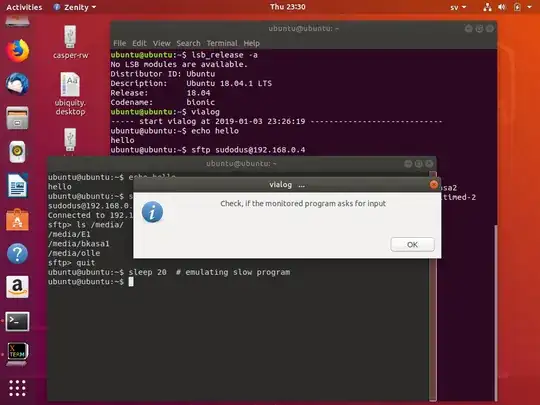

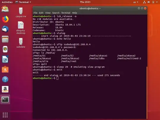

3. Ubuntu Server monitored remotely via ssh
A special version might be made for Ubuntu Server that works in text mode unless the GUI tool works via a terminal window and via ssh.
I checked, and these tools work with a server via a text mode connection via ssh to a computer with a graphical desktop environment.
  • The following screenshot illustrates how vialog is started in the client (a laptop with Ubuntu persistent live).
  • Then ssh connects to the server and performs some time-consuming task (here illustrated by copying a couple of big iso files.
  • It takes enough time to copy the Ubuntu Studio iso file for the alert to be activated, when the command wants a decision from me in the middle of the process (overwrite or not).
