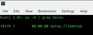

It seems that the 'ps -A' will truncate the output
With the:
$ watch -n 1 'ps -A | grep baloo'
