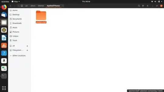

  1. Create a folder "myShellTheme" or any name as you wish in /usr/share/themes/
  2. Create subfolder in "myShellTheme" named "gnome-shell"
  3. Copy the required theme file
    sudo cp /usr/share/gnome-shell/theme/gnome-shell.css /usr/share/themes/myShellTheme/gnome-shell/
  4. Close all the files, Open Gnome-Tweaks and Select "myShellTheme" under User Themes
