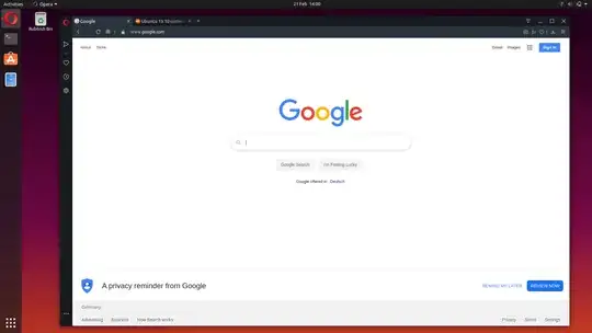

On my fresh install of Ubuntu 19.10 dual-booted with Windows 10 Pro, the bar at the top of my screen that shows what program is open is grayed out. It still works but the app icon is gray. Can someone please help me with this issue?
Screenshot of Opera icon grayed out

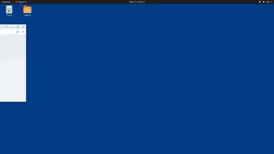

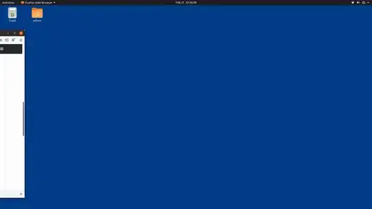

I have changed it to
#panel .panel-button .app-menu-icon {
  -st-icon-style: none;
  margin-left: 4px;
  margin-right: 4px; }
