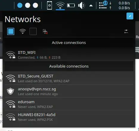

By Network Manager (GUI) I mean this - enter image description here
