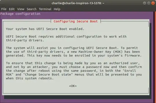

This then loads the following familiar UEFI screen attached below:
Configuring Secure Boot
Problem is I'm scared of continuing that screen incase it fails again and borks my booting process.
How can I fix the dpkg error without having to continue with the UEFI configuration process?

Problem resolved by turning off Secure Boot in BIOS settings, restarting and running sudo dpkg --configure -a.
