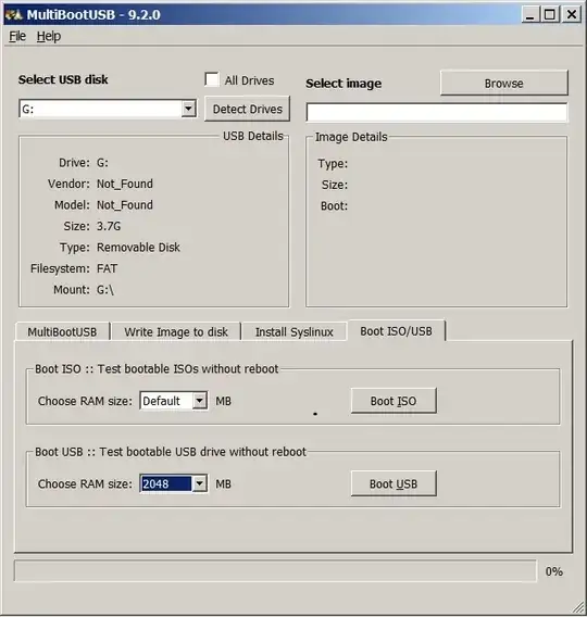

Boot ISOs or Live USBs in Windows
MultiBootUSB, ( http://multibootusb.org/page_download/ ) will allow you to boot a Ubuntu ISO or Live USB in Windows, (or other OS) using QEMU.
MultiBootUSB-QEMU
