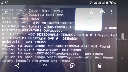

Please see attached screenshots of BIOS startup settings.
I (you don't need to tell me how stupid I was) accidentally deleted /sda1 on an Ubuntu 16.04 machine resulting in damaged EFI Boot settings.
But I was smart, too, as I had a current backup.
Ran boot recover utility - no joy.
Re-installed the Ubuntu operating system but keep getting these horror messages when booting up so I'm pretty sure it's not a OS problem. Most certainly a BIO/EFI issue.
(the screenshot with the dark background pretty much says it all)
I can boot with Ubuntu usb and access drives, etc. but booting from the hard drive just doesn't work.
Tell me what you need to know to help me. Output of commands will be gladly provided.
boot up error efi

i face the same issue as jeffschips. After upgrade my system fails with
Failed to open \EFI\BOOT\mmx64.efi - Not Found
Failed to load image \EFI\BOOT\mmx64.efi: Not Found
Failed to start MokManager: Not Fond
Something has gone seriously wrong: import_mok_state() failed
