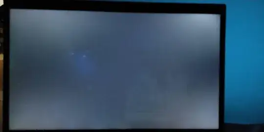

To give you an example, I'm sorry but I literally took a photo of my laptop's monitor.
Here's a full screen YouTube video of a pure black screen, for 10 hours (It's just a video of all-black playback):
pic1

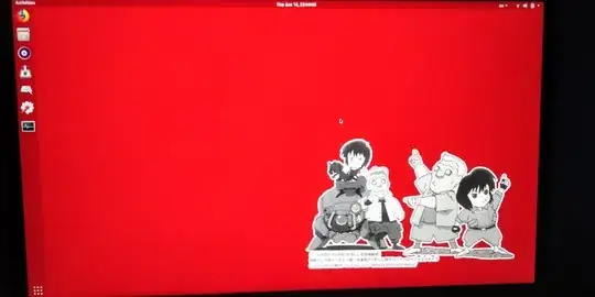

The image in the back (the ghost image I was seeing) is of course, nothing else other than my wallpaper:
