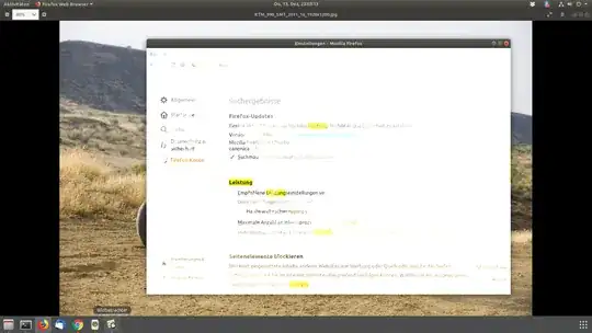

The problem looks like this: Problem

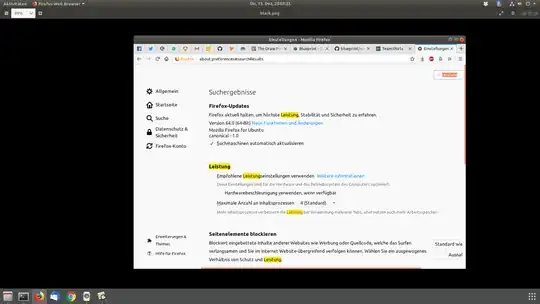

Notice the front wheel of the motorbike image behind Firefox appearing in the image from the new tab page. This got me thinking, the parts of the new tab image, that are over dark parts of the image behind it, appear kind of normal. So i created a black.png and have this (directly) behind Firefox.
This looks like this, quite normal, as expected: Expectation

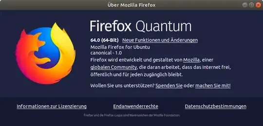

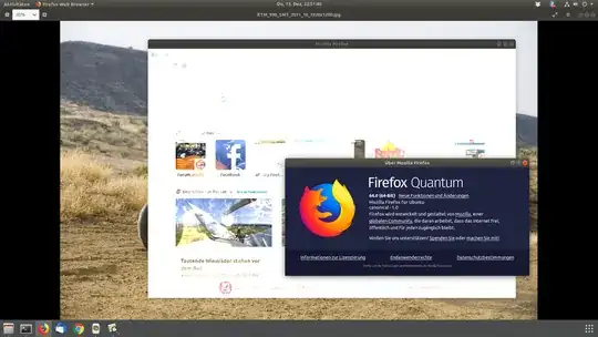

The About Mozilla Firefox window seems not affected, even when the image is acquired by AltPrint: About not affected

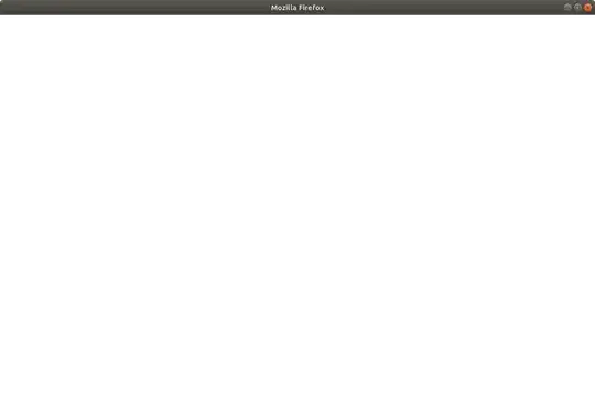

For the main window, creating the image by AltPrint is even worse: About not affected
Only the window decorator is there, the content of the window is completely transparent.

After some googling I suspected the hardware acceleration. But turning it off made no difference: About not affected
The only thing that helps, is a black background: About not affected
