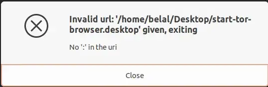

Doesn't work even after changing execution Permission, I can run the script from the terminal, but I do like to make it work as a Desktop Entry if possible.
I get the Error:
Can you please tell me how can I fix that please? thanks in advance.
Bilal
  • 357
Once you moved the entire tor-browser_en-US directory to the location where you want to keep it, move into the directory (it contains the start-tor-browser.desktop file) and run
./start-tor-browser.desktop --register-app
This will automatically install a .desktop launcher in your ~/.local/share/applications directory, so a working icon will appear in your applications menu.
You can find this information in the .desktop file.
