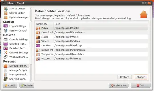

enter image description hereUbuntu tweak might be helpful (I've never tried it on 11.10 but it works on 10.10) there is a section for Default folder Locations in Ubuntu tweak and you can change the folders, But I think you may need to mount the partitions after each reboot for access files through Home folder :-)
