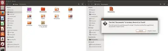

I reboot. Disaster. Click image below.
  1. The Documents folder is missing from the Places shortcut
  2. The original Documents folder is now vanilla
  3. The symbolic link inside the Documents folder is broken
Also, this reverted again: XDG_DOCUMENTS_DIR="$HOME/"
I used xdg-user-dirs-update --force to reset Documents back to its default.
