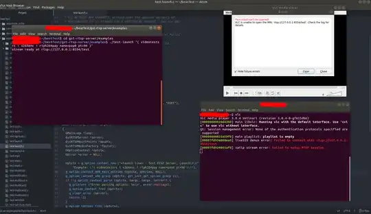

I then downloaded VLC media player and launched it within a terminal, but when I try to play the resulting stream rtsp://127.0.0.1:8554/test, I get errors. enter image description here
Am I doing something wrong?
Why can't VLC connect to my rstp server and stream what's diffused(the test video)?

I have a similar issue. My workaround right now is to launch Firefox and enter rtsp://(ip):(port)/test. This allows me to launch either VLC or the built-in Videos application in Ubuntu. Both work fine when launched from Firefox.
