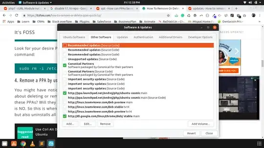

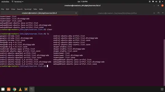

Content List of my /etc/apt/sources.list.d/

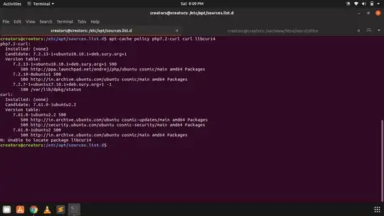

output of apt-cache policy php7.2-curl curl libcurl4

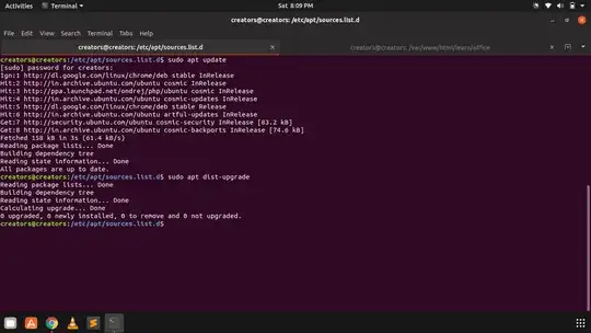

Output of apt update and apt dist-upgrade

The problem: When preparing your dist-upgrade, looks like you made mistakes:
  • You failed to disable a 17.10 repository.
  • You failed to uninstall non-Ubuntu software, and did not disable those PPAs.
Now you are stuck with a mixture of wrong-version packages which are (understandably) blocking apt. We would usually call this a partial or incomplete upgrade. All this information is from the output you provided.
The solution: You have two options:
  1. Clean up the mess.
    • Uninstall all PPA and other non-Ubuntu software, and disable the sources they came from.
    • Disable the 17.10 repo.
    • Then run an apt update and then an apt dist-upgrade to get you as close to stock 18.10 as possible.
    • Then, one by one, start adding back non-Ubuntu sources and software.
  2. If you don't know how to do #1, then preserve your data and do a clean-install of 18.10.
