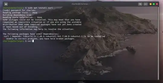

I use Ubuntu 20.04.1 and trying to install cURL. When I run sudo apt install curl in the terminal I get an error of:
The following packages have unmet dependencies: curl : Depends: libcurl4 (= 7.68.0-1ubuntu2) but 7.68.0-1ubuntu2.2 is to be installed
E: Unable to correct problems, you have held broken packages.
I have tried to follow this slightly similar solution unsuccessfully.
This is the screenshot of the error as it appears in my computer:
screenshot of my error

You actually have libcurl4 from focal-updates while APT is trying to install cURL from focal since you don't have focal-updates updates enabled (anymore?). At this point you have 2 options. Either enable focal-updates repository or install libcurl4 from focal.
  1. To enable focal-updates, run
    echo "deb http://archive.ubuntu.com/ubuntu focal-updates main restricted universe multiverse" | sudo tee -a /etc/apt/sources.list
    Once done, run sudo apt update and retry installing cURL.
  2. To install libcurl4 from focal, simply run
    sudo apt install libcurl4=7.68.0-1ubuntu2
    Retry installing cURL.
The later one might not work if you have packages dependent on installed libcurl4, i.e., version 7.68.0-1ubuntu2.2.
