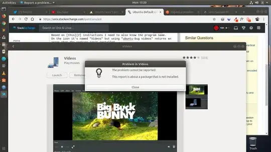

I want to report a bug with the default video player in Ubuntu.

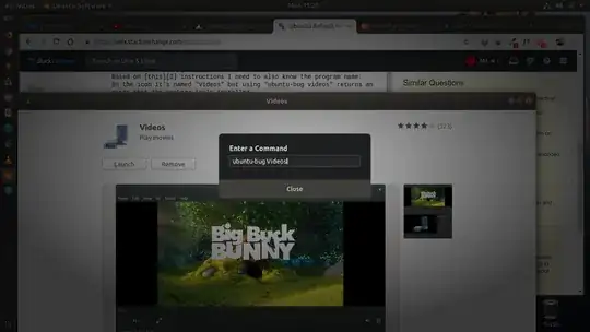

Based on this instructions I need to also know the program name. On the icon it's named "Videos" but using ubuntu-bug videos returns an error that the package isn't installed. That is the name of the app.
App Visible on the background using Alt+F2 to trigger an error reporting modal. That states there's no such app with that name
