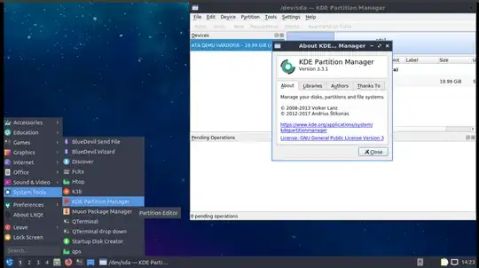

Anyway, the user can simply re-install partitionmanager with sudo apt install partitionmanager after which it will appear in the menu as KDE Partition Manager.
