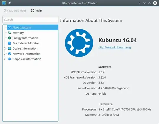

In modern Kubuntu there is an Info Center app which you can find in K menu -> Applications -> System -> Info Center or start from console using kinfocenter. It shows Plasma version, Frameworks version, Qt version and other useful info.
Info Center
