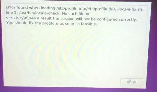

After downgrading my Ubuntu from 18.10 to 18.04 when ever trying to login I am getting the following error:
view error screenshot
And opening the terminal following error displays
bash: /usr/bin/locale-check: No such file or directory
How can I fix this error?

The problem is that the base-files package starting with version 10.1ubuntu2.6 (bionic-updates pocket) or newer (cosmic and later releases) contains some additional files, compared to the bionic release version and older:
  • /etc/profile.d/01-locale-fix.sh
  • /usr/bin/locale-check
Files in /etc are config files though, which will not normally get removed along with the package, unless you apt purge it. Especially during a downgrade, which isn't officially supported anyway, removing such files will not be taken care of.
That is why, after downgrading from a newer version to the one 18.04 initially ships with, you get the "File not found" error - the shell initialization script in /etc got left behind as residual config, while the required executable got removed properly according to the requested downgrade. This is also explained in the reply to @roganartu's rejected bug report.
The recommended solution is to fix your software repositories configuration and enable getting packages from the bionic-updates pocket again, then upgrading base-files to that version. /usr/bin/locale-check should be back again.
Alternatively, if you insist on staying with the release pocket and not enabling updates, you will either have to manually delete /etc/profile.d/01-locale-fix.sh, or you might possibly try forcefully purging and reinstalling base-files.
