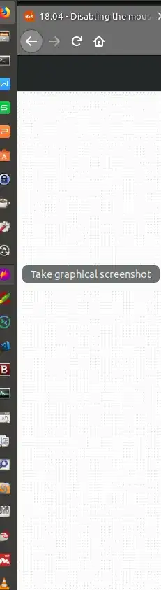

I need to know if it is possible and how to disable the Ubuntu 18.04 Dock tool-tips for mouse hover the pinned application.
