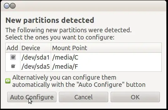

Install ntfs-config from the package manager and click on auto configure on first start.
This
