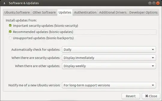

During chat session we have discovered, that bionic-updates repository was disabled.
So we have enabled it from Software & UpdatesUpdates tab (software-properties-gtk):
enabling bionic-updates
and then confirm reloading of package lists.
